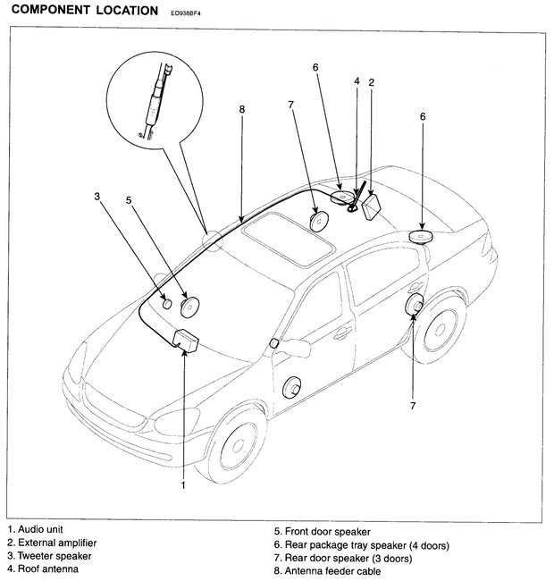

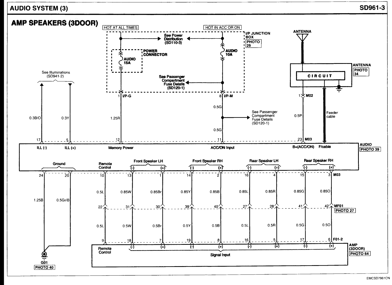

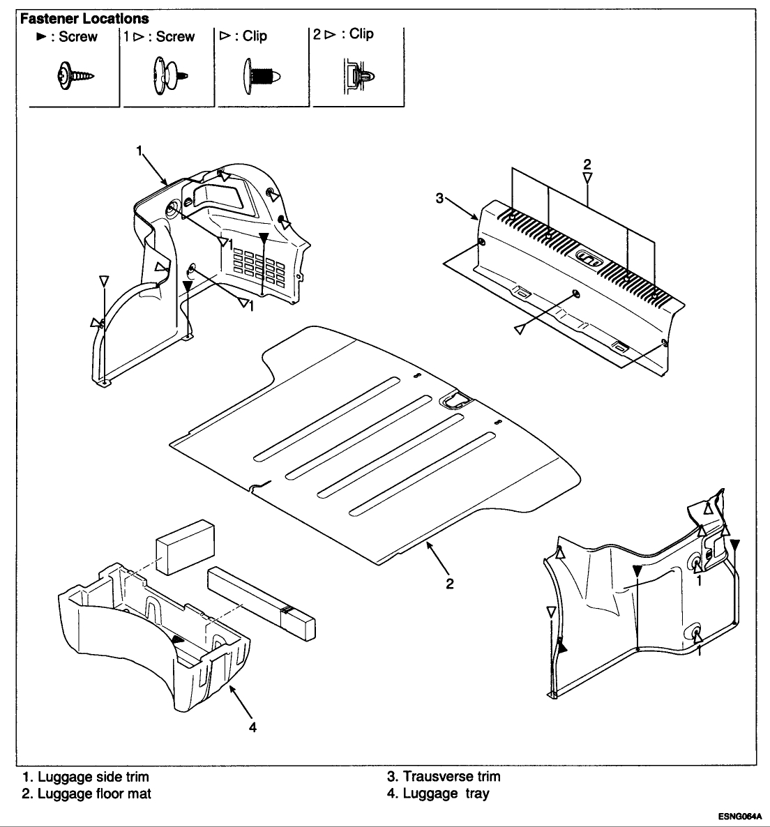

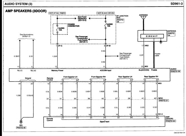

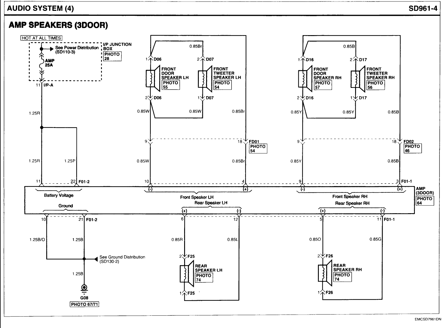

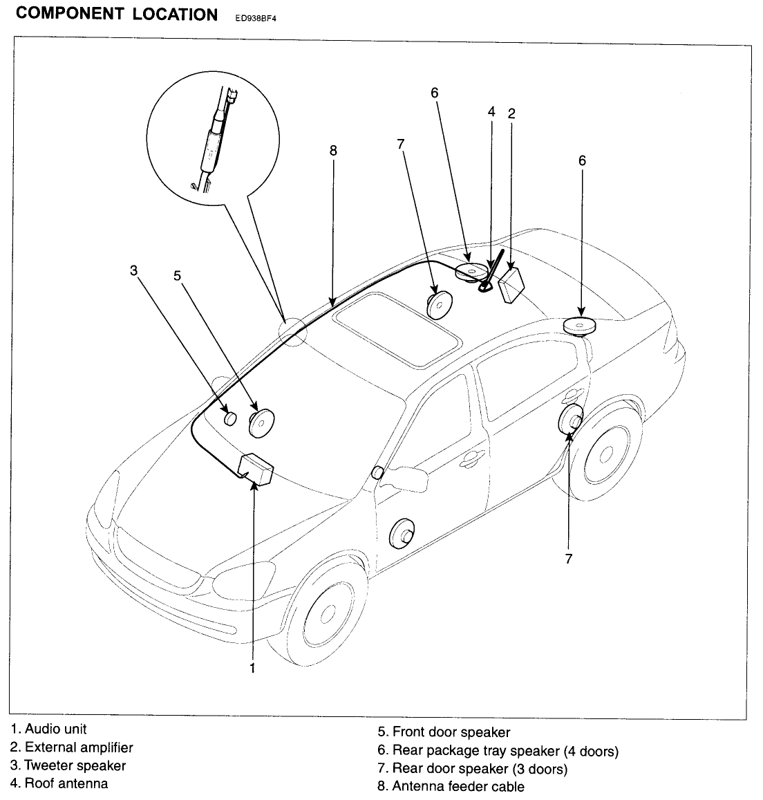

Where is located the factory amp? This is the SE hatchback model.
Feb 14, 2018 at 8:10 AM
STEVE W.
  • 15,349 POSTS
If it has one it will be behind the right rear trunk trim panel under the hatchback. Remove the screws and clips and the amp is mounted to a bracket. Check out the diagrams (Below). Please let us know what you find. We are interested to see what it is.
