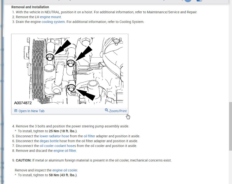

I left my truck sit when we had cold weather. It was fine when I parked it. I tried to start it when it warmed up outside and it ran really bad for about 10 seconds and I shut it off. I then saw water in my oil. not milky brown just under the oil in the pan I drained it and all the water came out first and then just oil not mixed but both in the pan, again not milky at all. I disconnect my coolant tank and my oil cooler lines and put the hose to the reservoir line . No more oil filled in the engine or pan and it just came out the oil cooler lines.should I assume at this point it is likely the oil cooler?
Feb 22, 2021 at 5:05 AM

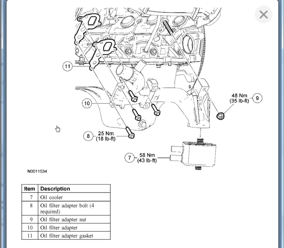

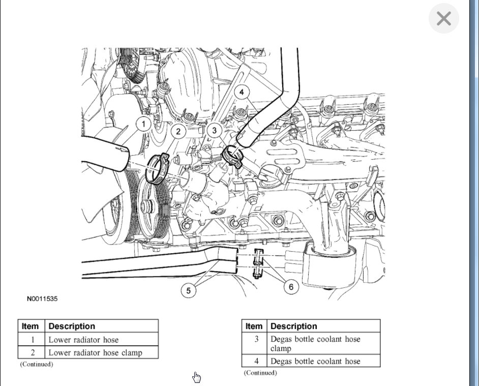

I agree with that. However, if you want to confirm the head gasket is not the issue then run though this guide:
https://youtu.be/5zpNjYmmiYY

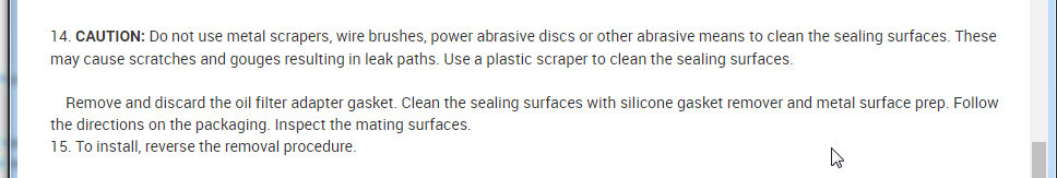

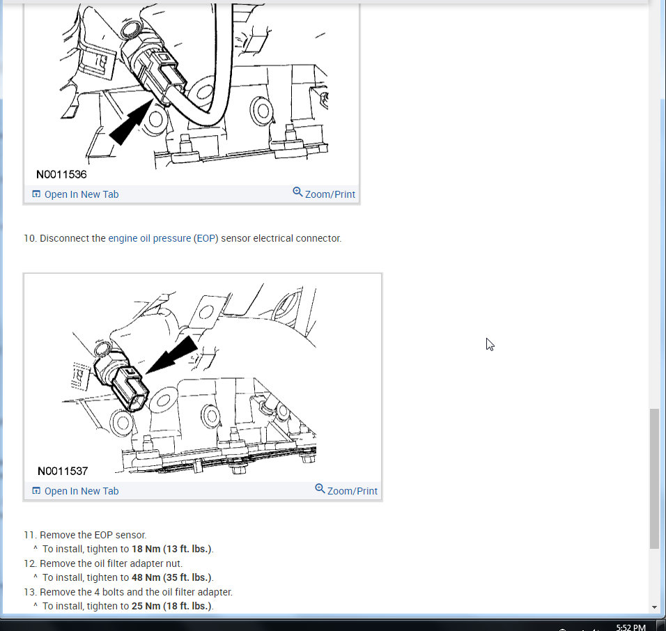

Once you confirm it is not a head gasket then I would go ahead and replace the cooler. I attached that info below.
Let us know how you make out. Thanks
