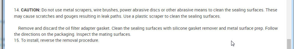

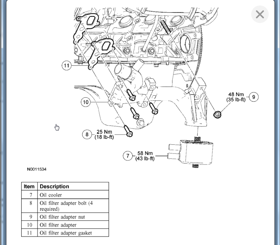

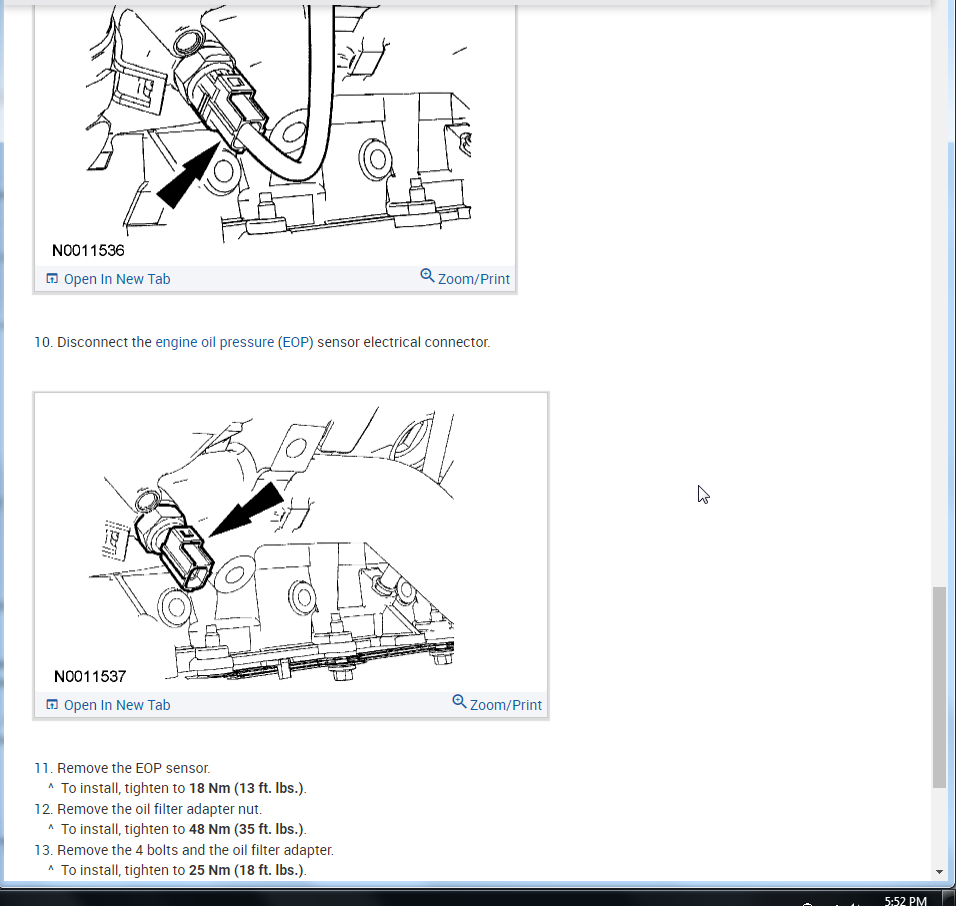

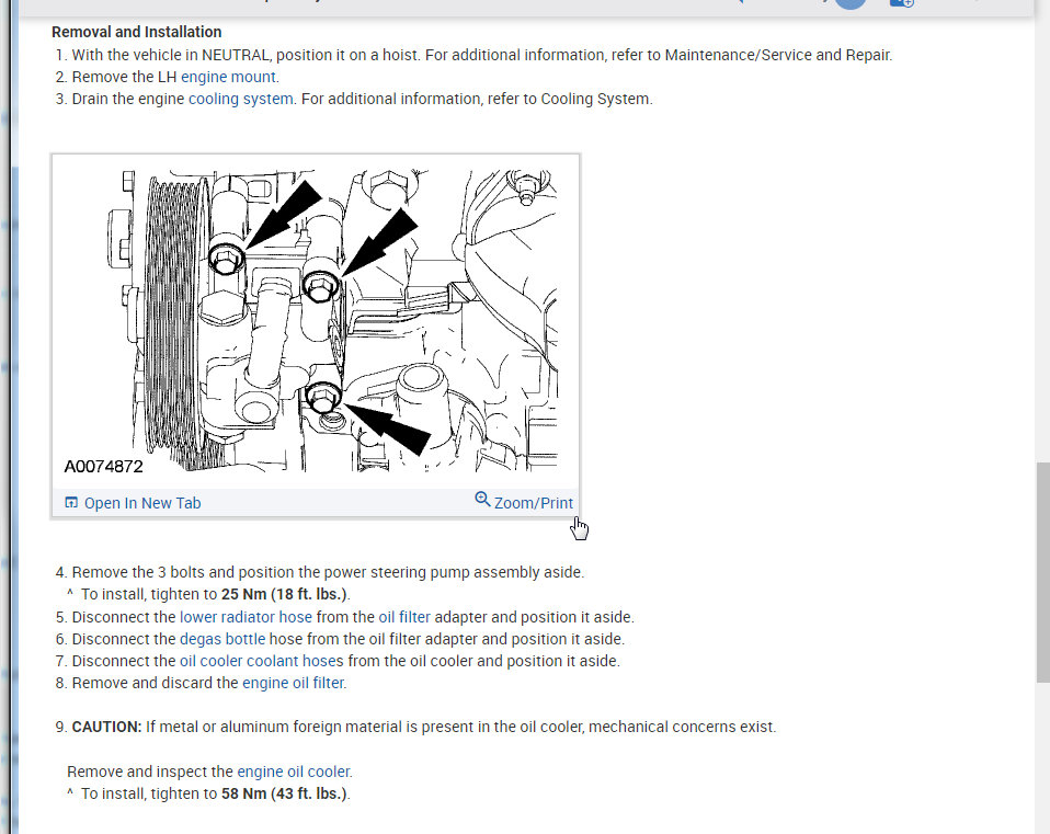

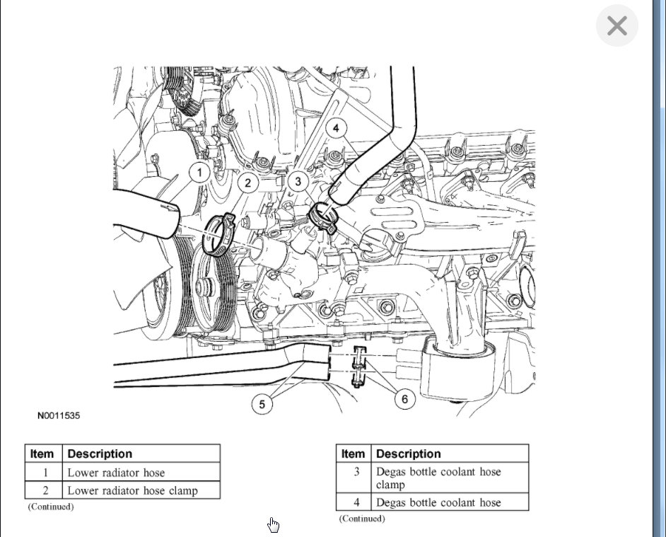

I agree with that. However, if you want to confirm the head gasket is not the issue then run though this guide:
https://youtu.be/5zpNjYmmiYY
Once you confirm it is not a head gasket then I would go ahead and replace the cooler. I attached that info below.
Let us know how you make out. Thanks
