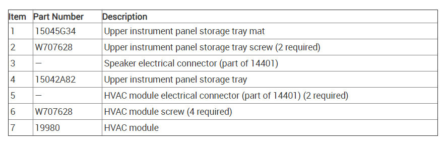

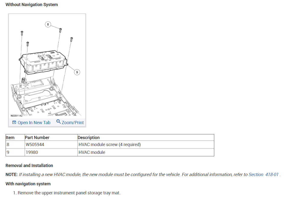

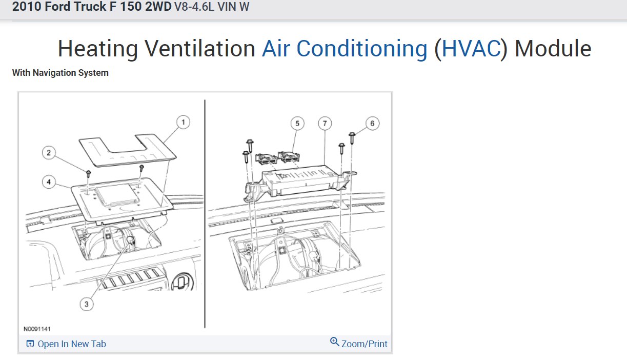

When you switch the climate control from hot to cold can you feel the actuator working? If not it sounds like the control module has gone out which happens. to be sure lets do a CAN scan which is the future of automotive repair. you can get a CAN scanner from Amazon for about $50.00. here is a video to show you how:
https://youtu.be/u-4syLc-ifQ.
Here is the instructions on how to replace it. Check out the diagrams (below). Let us know what happens and please upload pictures or videos of the problem.
