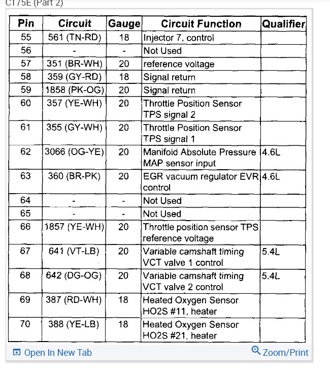

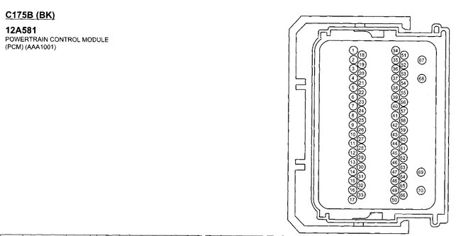

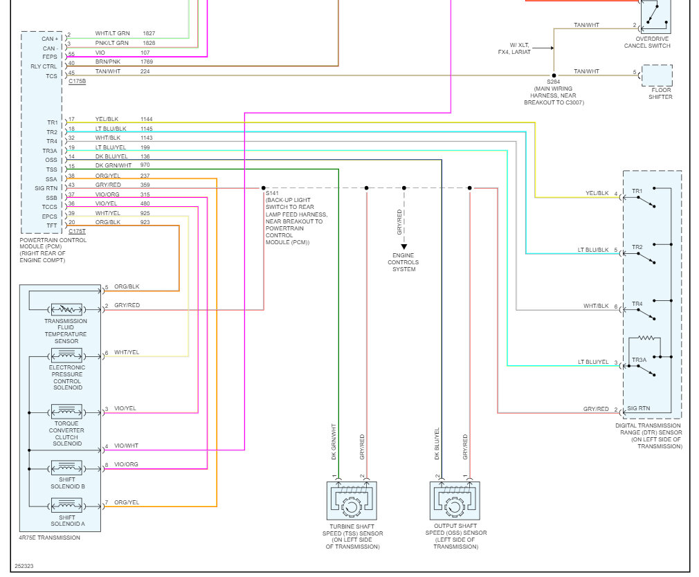

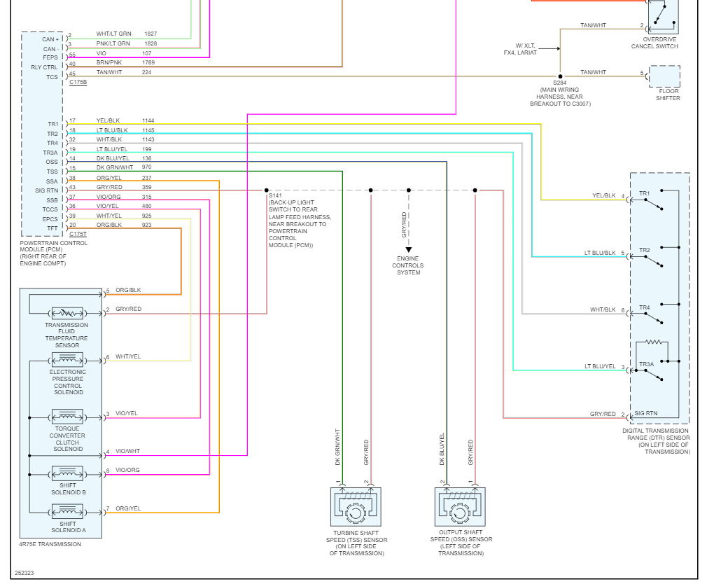

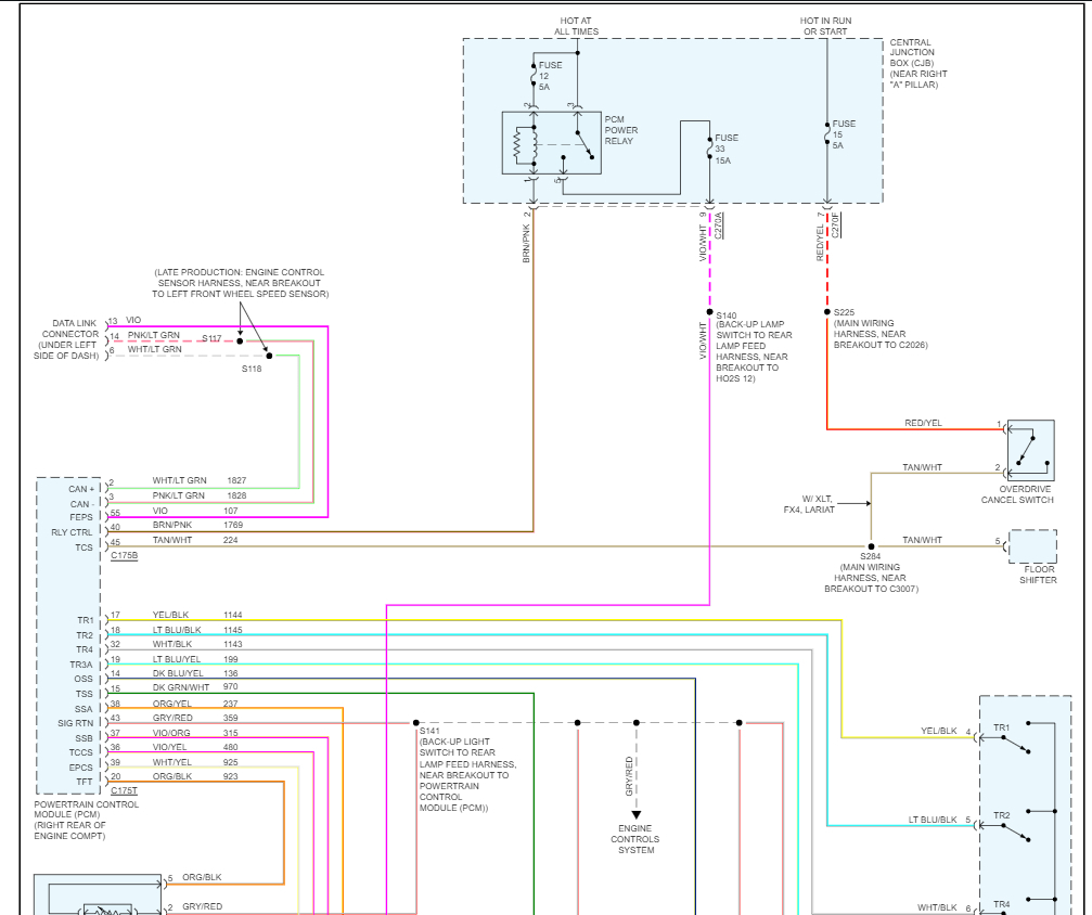

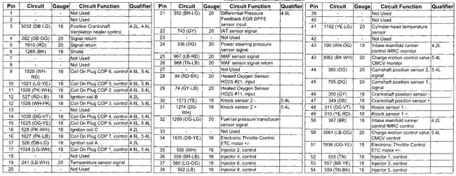

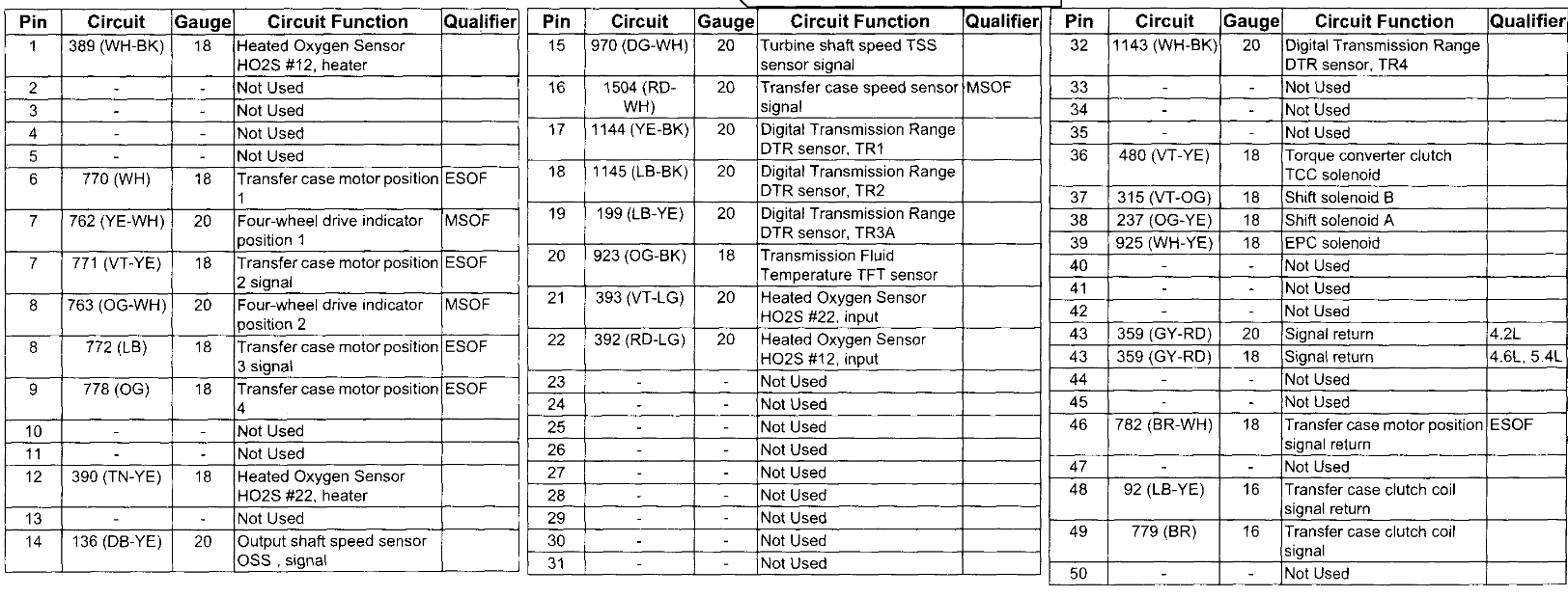

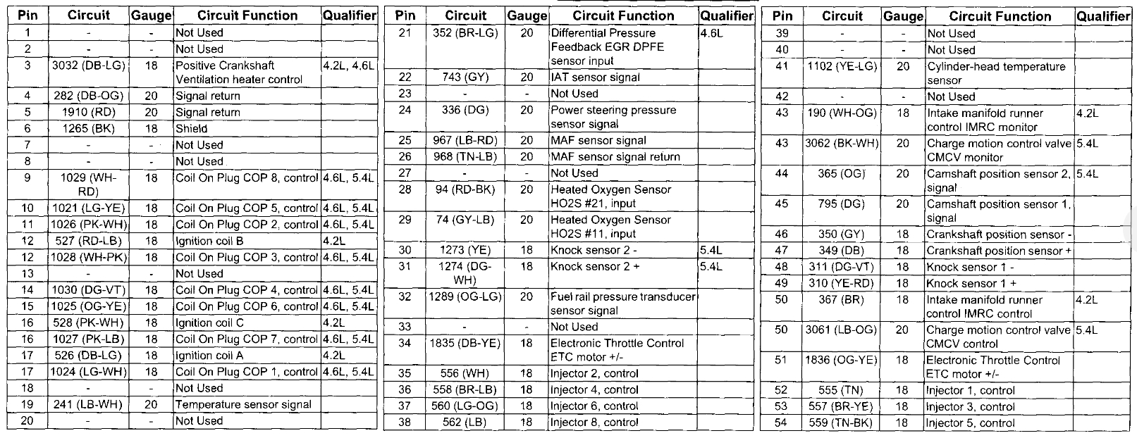

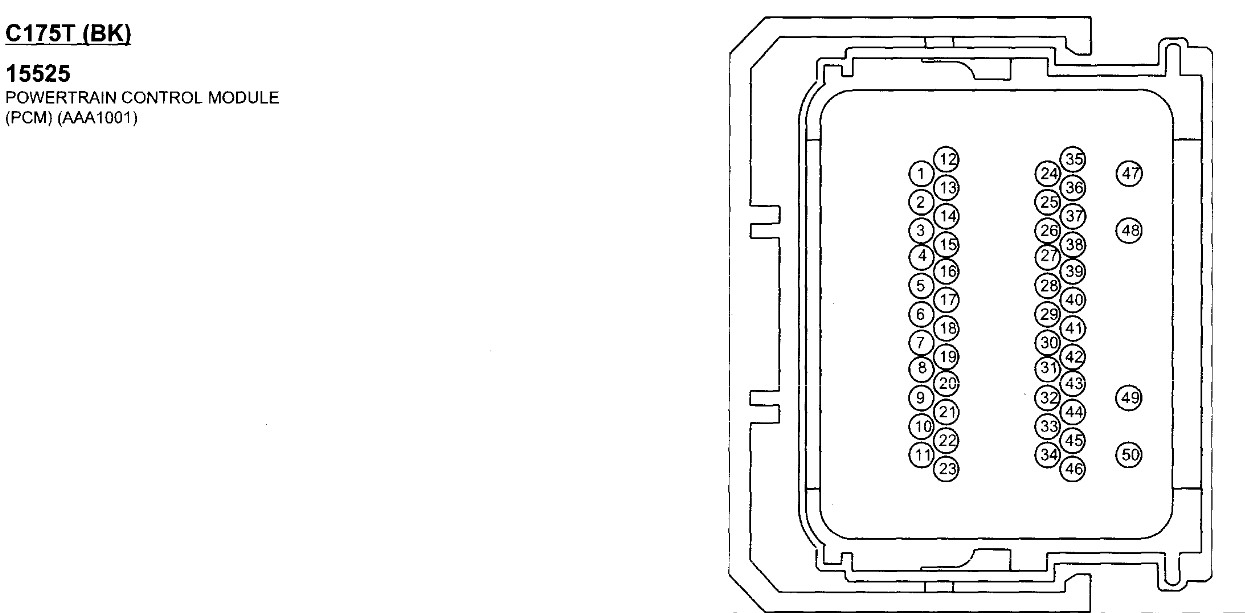

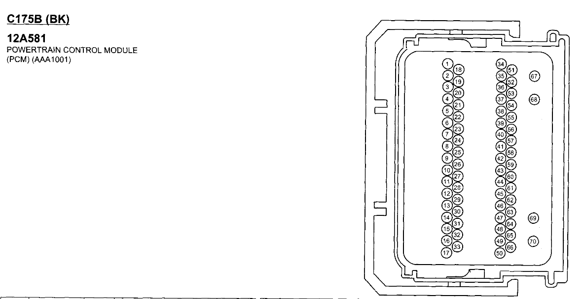

I can't find the pinout for the PCM. I am concerned about the transmission connector side but a comprehensive one would be amazing.
Its:
AFV3 7L3A-12A650-GAD
The truck listed above is an FX4.

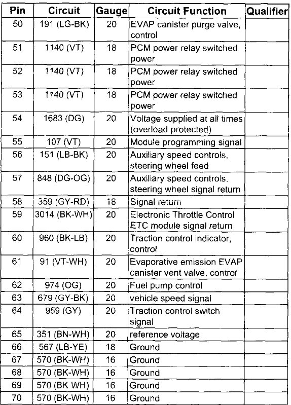

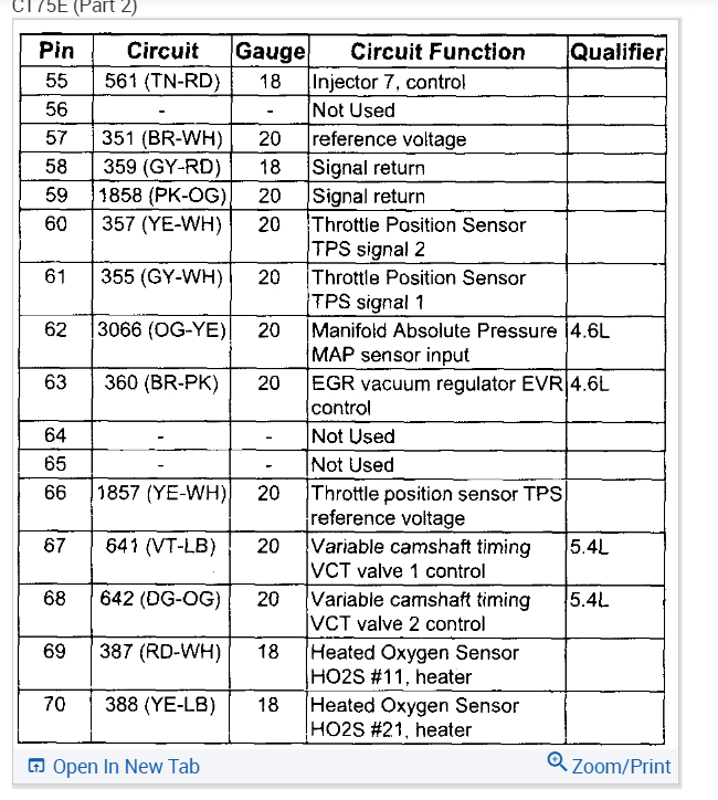

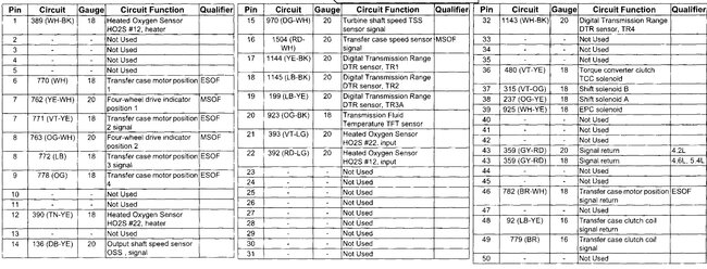

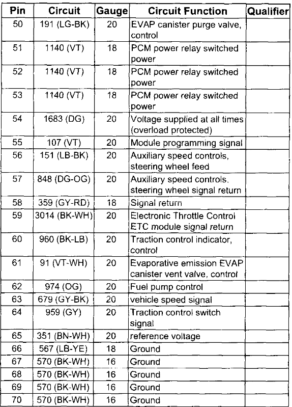

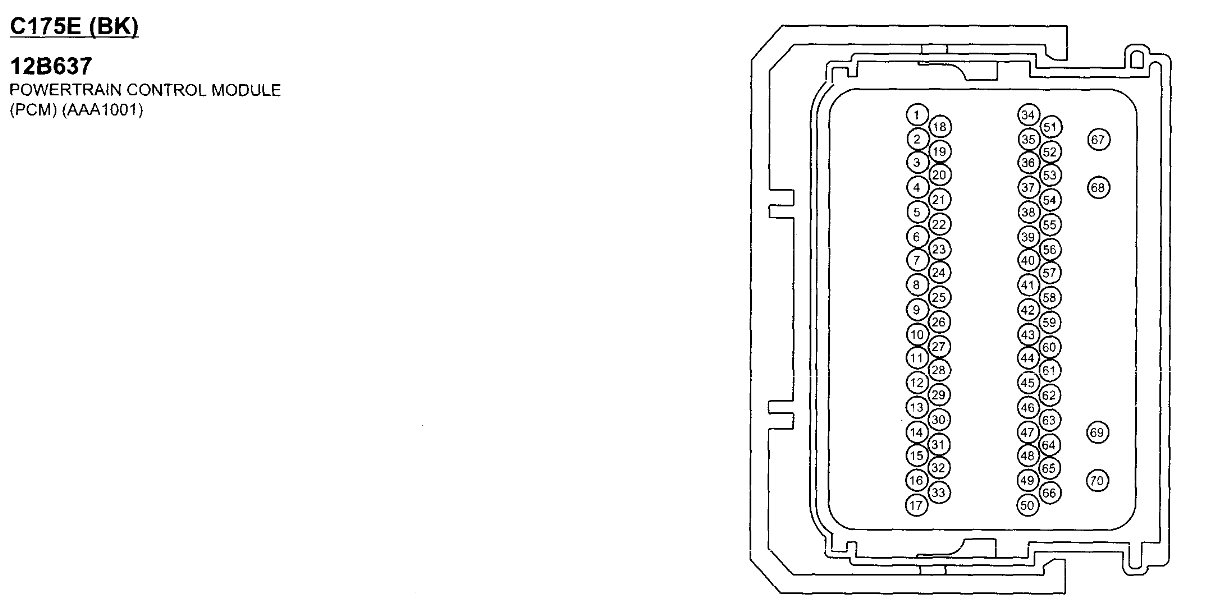

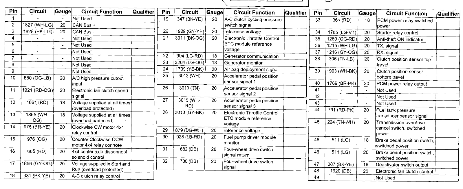

Sure here is the pinout for the PCM and I have included a guide to help you test the connections, I also included the transmission wiring diagrams.
Check out the images (below). Please let us know if you need anything else to get the problem fixed.
