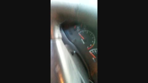

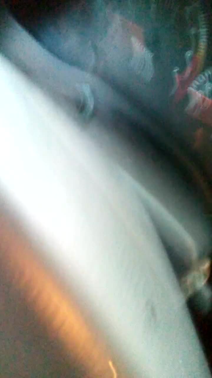

Video, thought it could show how hard the engine was hitting but it did not, but you get the idea, lol.
Monday, May 21st, 2018 AT 6:07 PM
  • 109,885 POSTS
Hi Steve and thanks for using 2CarPros.com. I hear a dead misfire from the video. So, we need to start there. First, it appears the check engine light is on. So, I need you to have the computer scanned to identify trouble codes. Once I get that, it will be much easier to narrow down the problem.
