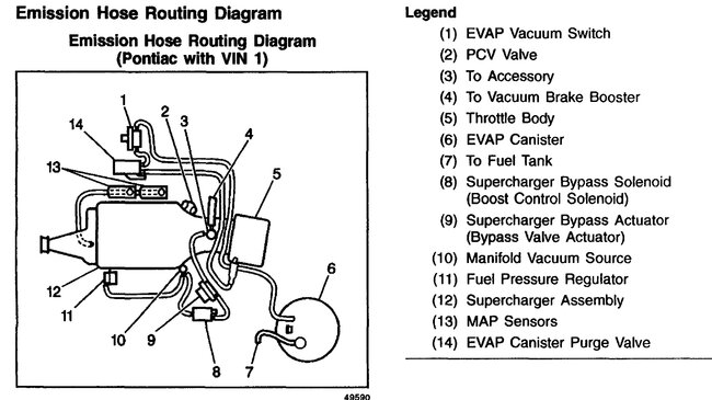

I replaced the lines with a configuration that an AutoZone employee helped me setup, however I’m unsure if the lines are in the right place, and would like a diagram and pictures to show exactly where and how they need to be attached. There is a diagram under the hood, however I can’t understand it, and it doesn’t show me, that I can see, where the vacuum lines exactly connect to the throttle body, as it has a top and bottom port. And I need to know where all the lines specifically run to that come out of the throttle body and exactly how they should be configured.

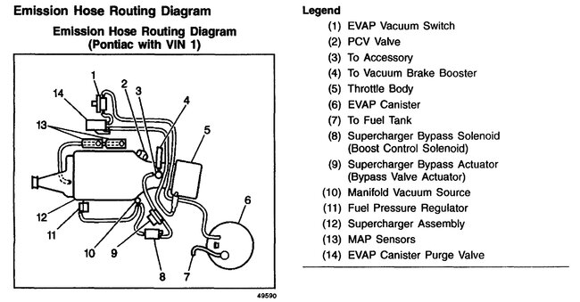

This hissing is not good, it sounds like you have a gasket leak at the throttle body so I would remove it to see if the gasket is broken. Here is a guide to help you when the engine is cold only:
Here are the vacuum line diagrams as well, also we should run the codes to see if any are stored:

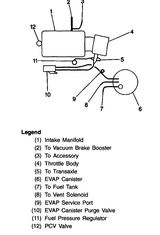

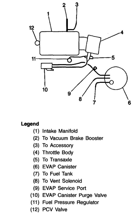

The engine on this car doesn’t have a supercharger, like what’s in that vacuum hose diagram that you sent me. The car has a diagram on it but even like on the one you sent, I can’t tell what’s going to the top and bottom port on the throttle body, can you?

My bad, here you go.
