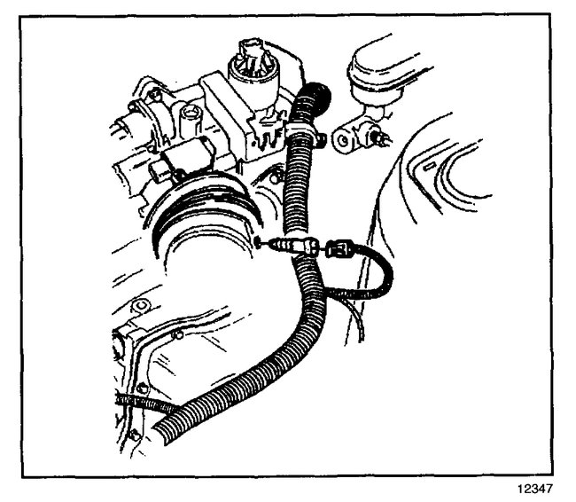

I ran the code again and it came up with P0113, which says it's a IAT sensor. Would that cause it to be so low?

I have to be honest, I don't think any one thing can cause it to be that bad. However, it wouldn't hurt to replace the sensor if it is indicating an issue.
Here are the directions for replacement:
PROCEDURES
INTAKE AIR TEMPERATURE (IAT) SENSOR REPLACEMENT
REMOVAL PROCEDURE
1. Disconnect the IAT sensor electrical connector.
2. Carefully grasp the sensor and with a twisting and pulling motion, remove the IAT sensor from air intake duct.
INSTALLATION PROCEDURE
1. Install the IAT sensor, snap the sensor into place.
2. Connect the IAT sensor electrical connector.
Let me know if this helps.
