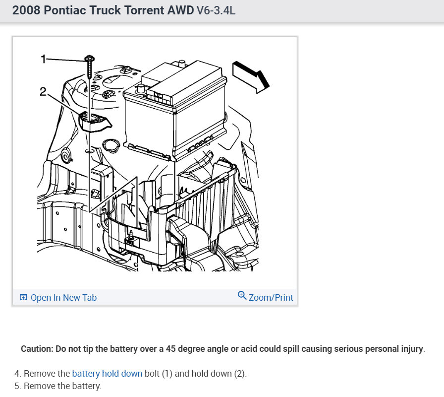

It is extremely cold in Michigan today and I drove the vehicle this morning but now when I tried to start it I have power but it just chimes a high low pitch and doesn't try to turn over. What's going on?

Hi Allee Whitehill, my name is Alex, a lifelong U of M Wolverine fan, and I will be helping you today.
So when you turn the key does your vehicle try to crank at all, or is it absolutely nothing when you turn the key?
Jan 30, 2019 at 4:29 AM
  • 55,433 POSTS

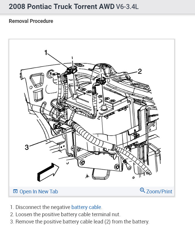

It sounds like the battery is weak. but to be sure here is a guide to confirm the issue with diagrams below:
and if it fails:
https://www.2carpros.com/articles/how-to-replace-a-car-battery
