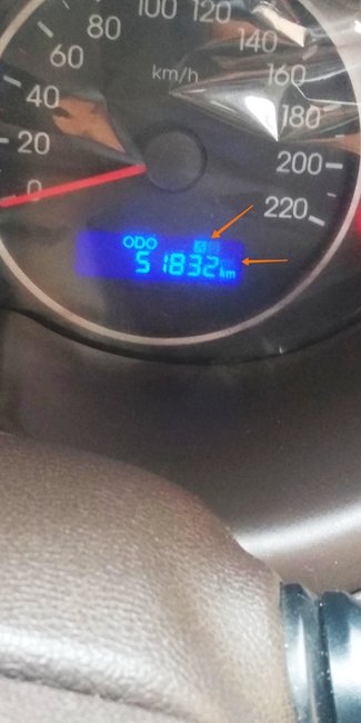

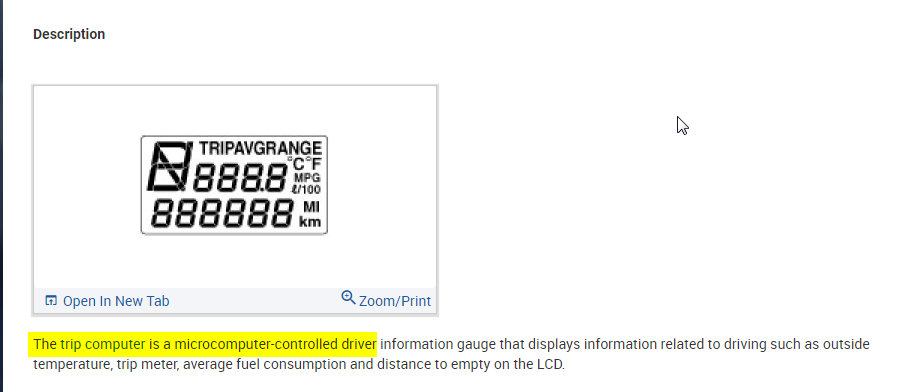

Just 2 days ago, I noticed that there are km and ml letters, and letters A and B displayed on the odometer screen when key is at on or engine running. After waiting for about 5 minutes, everything turns normal again. Refer attachment for clearer information.
In normal, it shows km and no A and B displayed, just blank.
No other issues with the car. Just those surprising extra letters!!!
How to fix it? What causes?? Please kindly help.

So A and B are called "trip" counters. Meaning it gives you the ability to track the miles/km for a given trip and they can be reset at any point to start that over and it doesn't effect the overall odometer.
With that being said, the picture did not attach. Can you try and attach another one so that we can see what is happening?

If they are trip counters, how to select a and b?? There are no control buttons on my steering wheel??? Is it a light bleed???
Oct 21, 2020 at 4:35 PM
Oh. I see. So they are just barely visible. Pictures truly are worth a 1,000 words because I think you are correct. It may not be a light "bleed" because that is an LCD screen and does not have light bulbs but I do think that is a cluster issue. More then likely the circuit board is "bleeding" voltage to those items and they are showing up very dim. That is not unheard of. If it were me, I would just leave it as it is not bothering anything. I am sure it will still work if you switch to miles or try to use those trip meters.
The one thing you can try is a battery discharge and see if when it restarts it "fixes" itself. Disconnect both battery cables and touch the cables together and then leave them off for 10 minutes and reinstall them.
Even if this does work, it may come back but again, I would not mess with it but if you want to, you would need to replace the cluster.

Took out the instrument cluster panel and kept it under the hot sun for continuous 5, 6 hours to see if any moisture etc., is causing the issue.
Reinstalled the cluster and the battery successively.
1. Key is at on or engine running, yes, the screen is normal.
2. Removed the key and wait about 1 hour, repeated the same checking process, yes, still the screen remains normal.
3. Now, this morning (after about 18 hours), i repeated the same checking process.. i'm very disappointed to find that the issue still persists with those letters appearing vividly clear now, and like before, they dimmed out slowly after 5 minutes.
4. The fact that those letters dimmed away slowly is suggesting me that... they are controlled by a capacitor which discharged itself when key at on or engine running, and ultimately, those letters dimmed away. And, capacitor recharged itself when key removed. So, how to identify that capacitor or alike is leaking to cause such issue.

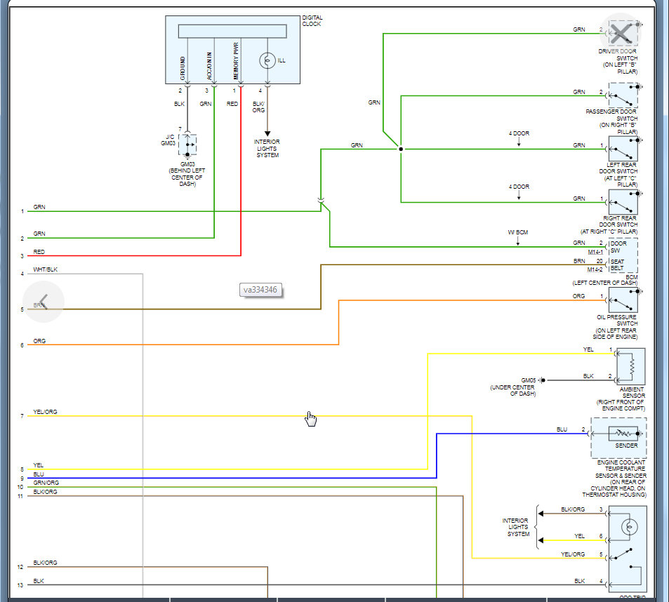

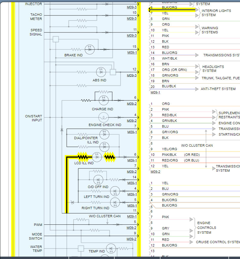

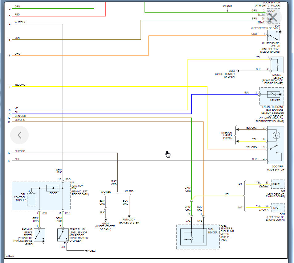

You are probably correct. However, we don't have a wiring diagram for your vehicle as it is not offered here in the USA but here is one from the USA version of your vehicle. While it may not be identical I am sure it is similar.
With that being said, the capacitor appears to be held in the cluster circuit board. As you can seen the interior lighting system runs this LCD screen and these capacitors are on the cluster board. So that means it would need to be replaced. If it were me, I would not worry about it but if you are going to make a repair, that is what I would replace.

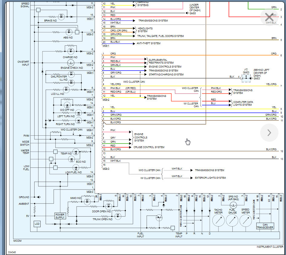

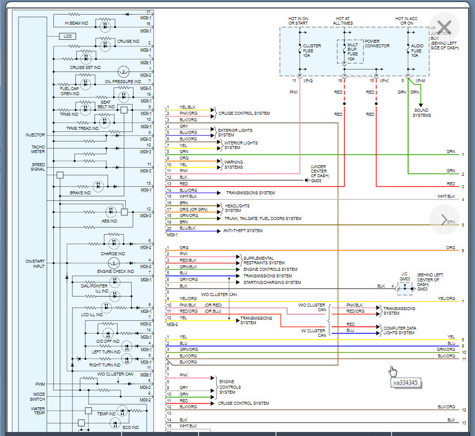

Please provide the complete whole circuit board diagram.
Nov 1, 2020 at 10:25 AM
I am attaching the entire cluster diagram which includes the inputs. Thanks

Yes, with your help the odometer is normal again. Thanks so much Indeed.
(I dissembled all the instrument cluster panel and even the gauges pointers and reassembled all.)
