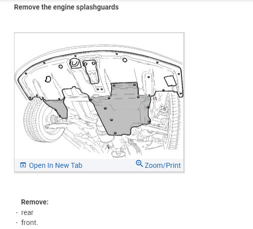

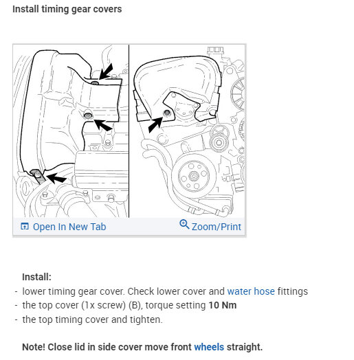

After doing the timing belt, crank seal etc., I find myself with 3 bolts I can't remember where they were. One is a 12mm head with red Loctite and the other 2 are 10mm heads, one of which also has Loctite. I'm hoping the Loctite will be a clue. Getting old stinks when the memory fails you. Hoping you can help. I don't think they are down by the crank gear anywhere.

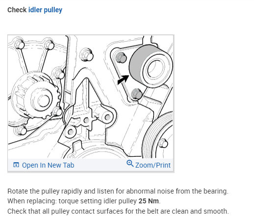

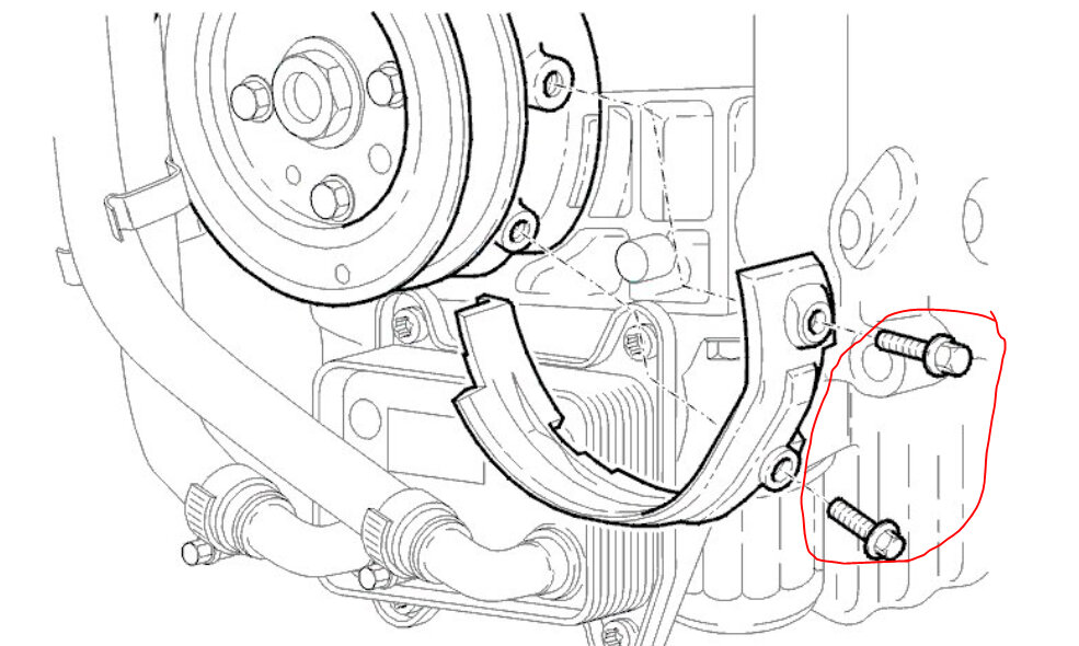

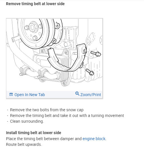

Oh boy. That's a tough one. The two 10mm bolts may be from the snow shield below the crankshaft pulley. See pic 1.

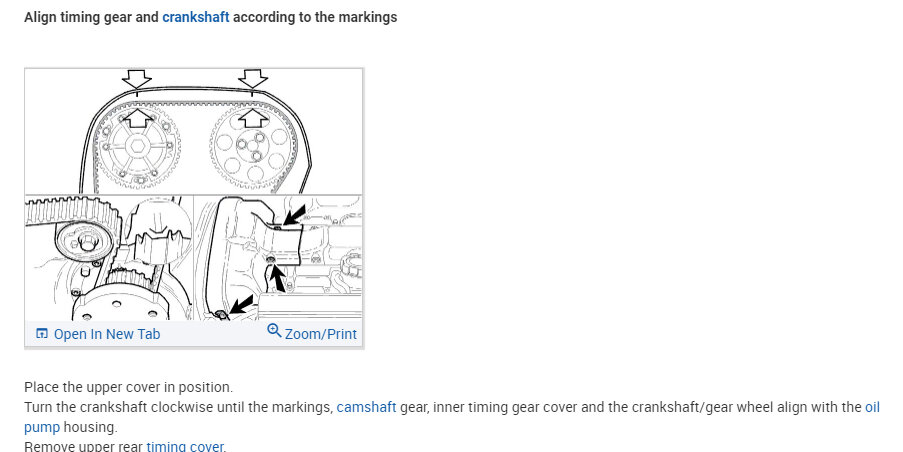

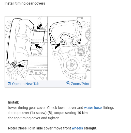

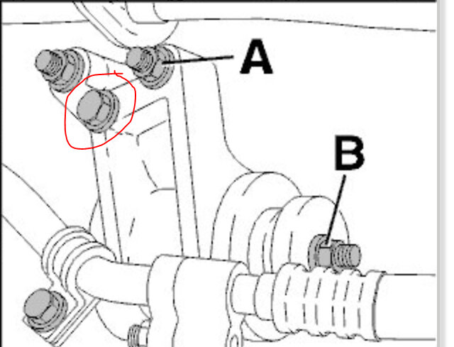

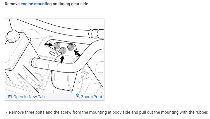

Also, check to see if you forgot one on the mount. See pic 2.
Sep 2, 2023 at 3:02 PM
JEFF HERMAN
  • 486 POSTS

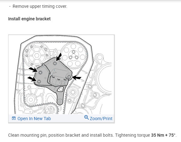

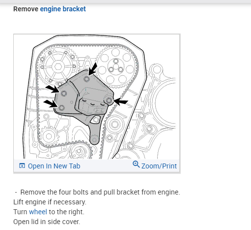

Got the 2 in the shield and the 3 motor mounts are 15s. The one on the hose looks interesting. Though the 12 went under the belt cover somewhere, which by the way fit like crap. The only thing that bothers me is the Loctite. Must be somewhere that has vibration issue. I'll keep looking.

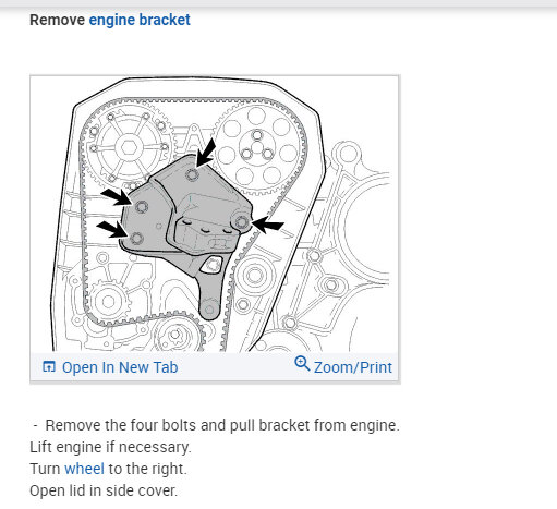

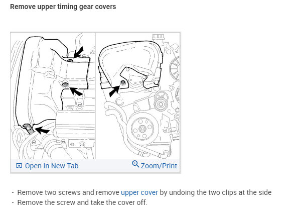

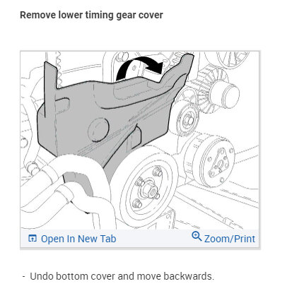

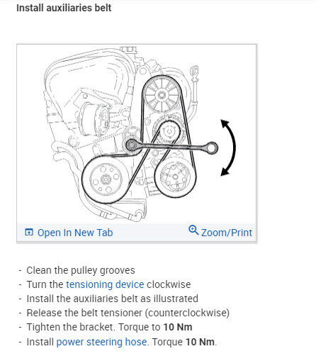

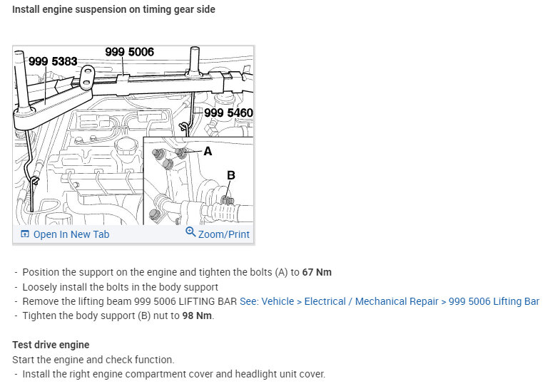

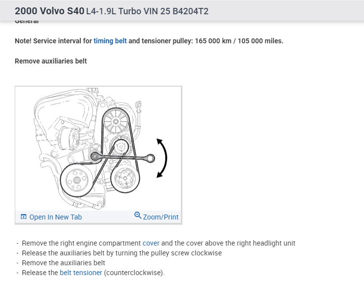

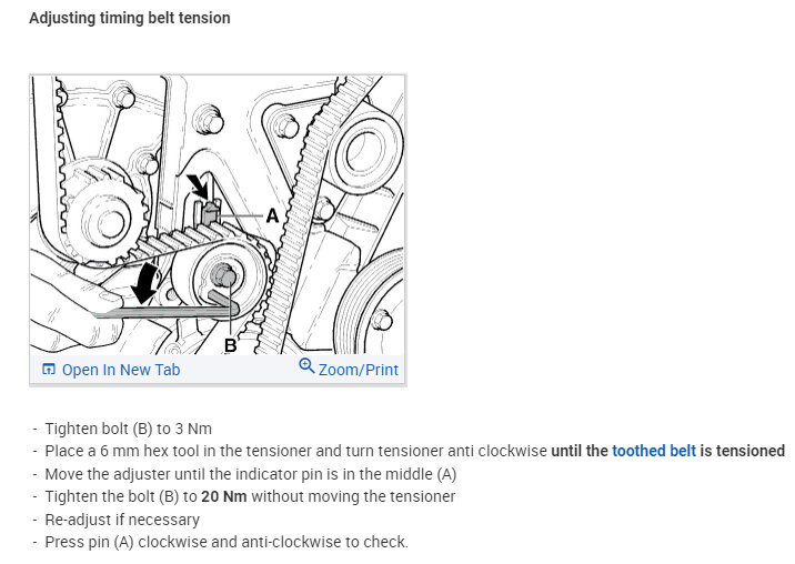

Jeff,

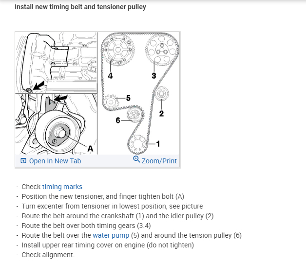

I attached the directions for replacing the belt below. Take a look through them and see if there is anything that stands out.
Watching the videos is also a good idea.
Let me know if this helps.

Nobody shows taking the bolts out. I think I removed some from the belt protector thinking I had to remove it. I remember the 12mm one in that vicinity. I'm going back in tomorrow and I'll find where they go. I hope. Thanks for your help.

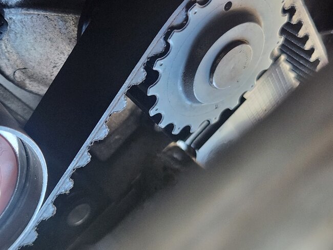

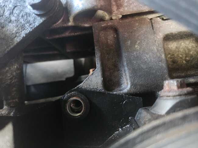

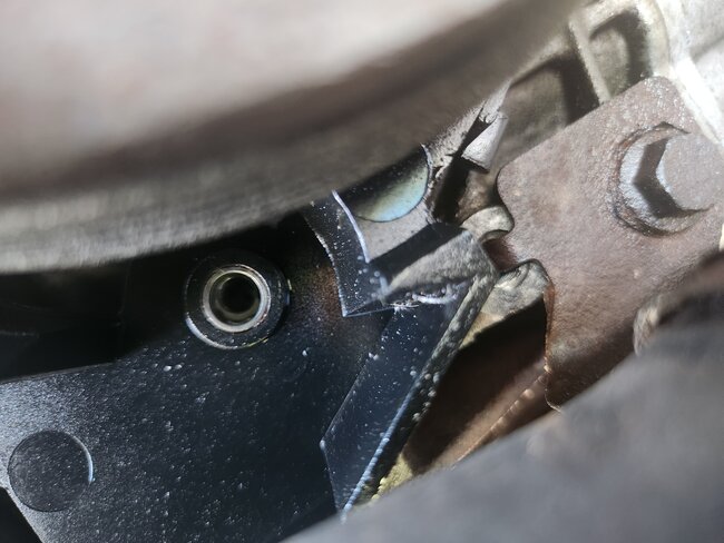

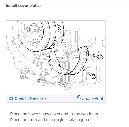

Found them all. First photo is the 12mm. Other two are 10mm. Third photo is under motor mount on block.
