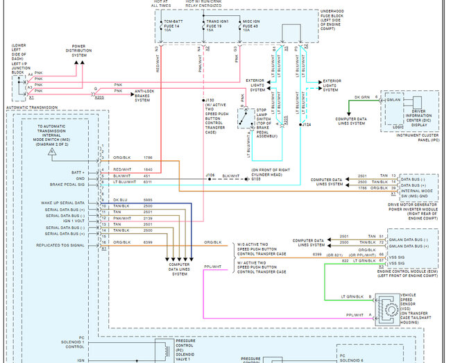

external connector wiring?
2012 CHEVROLET SILVERADO
210,000 MILES • 6.0L • V8 • 4WD • AUTOMATIC
LUJANE
my transmission is a 6l90 code 2D2A i recently had it rebuilt the external plug that goes into the transmission from wiring harness is a 16 pin but only has 9 wires going to it from the harness the plug that is cut off is gone the wires from the harness are 2 tan 2 tan/ black 1 pink 1 blue 1 red/white 1 orange/black 1 black/white i need to know where each wire goes on the 16 pin connector
Mar 31, 2026 at 7:10 PM
  • 55,433 POSTS
Here is the 16 pin electrical connector wiring diagram so you can see how the system works. This guide can help you test the wiring.
Check out the images (below). Let us know how it goes
