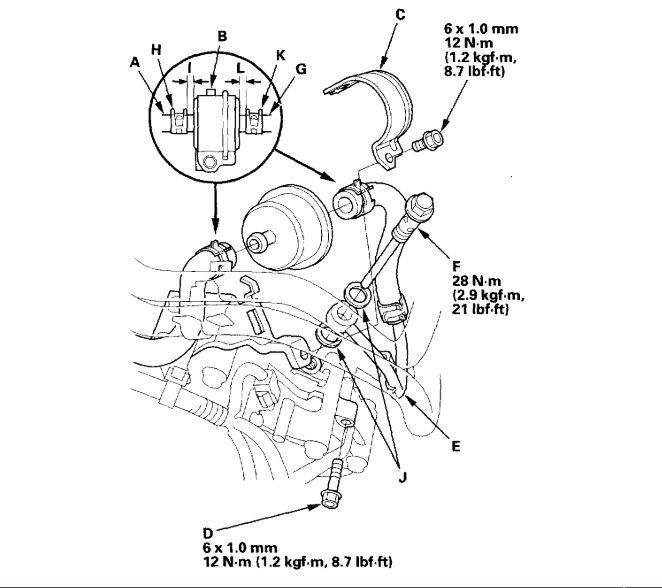

How often should the external automatic transmission filter be replaced?
What about the internal one?
Thank you,
MB
Jan 15, 2019 at 4:27 AM
Good evening,
The external should be changed at 50,000. The internal is done with a transmission overhaul. Here is a video of the job being done
