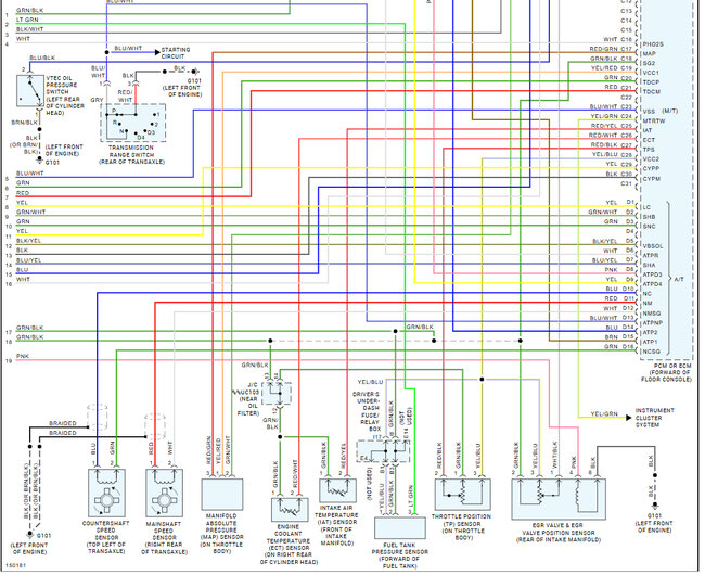

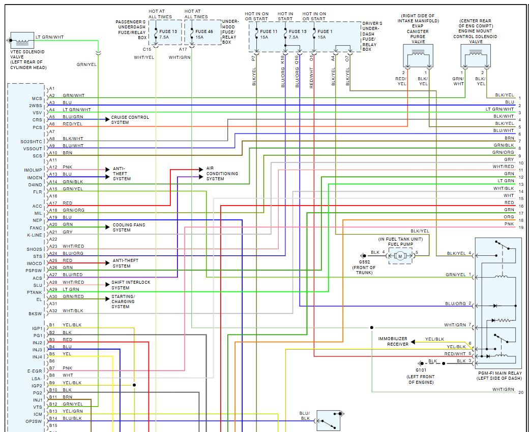

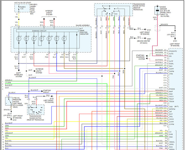

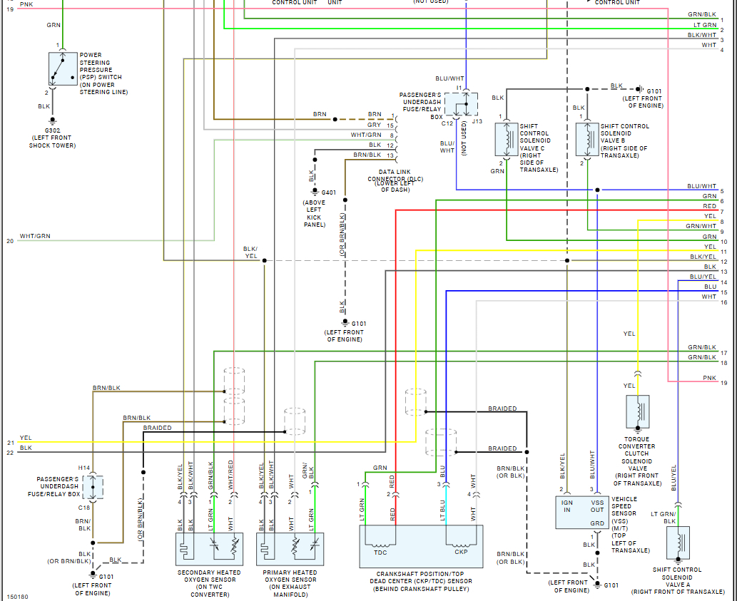

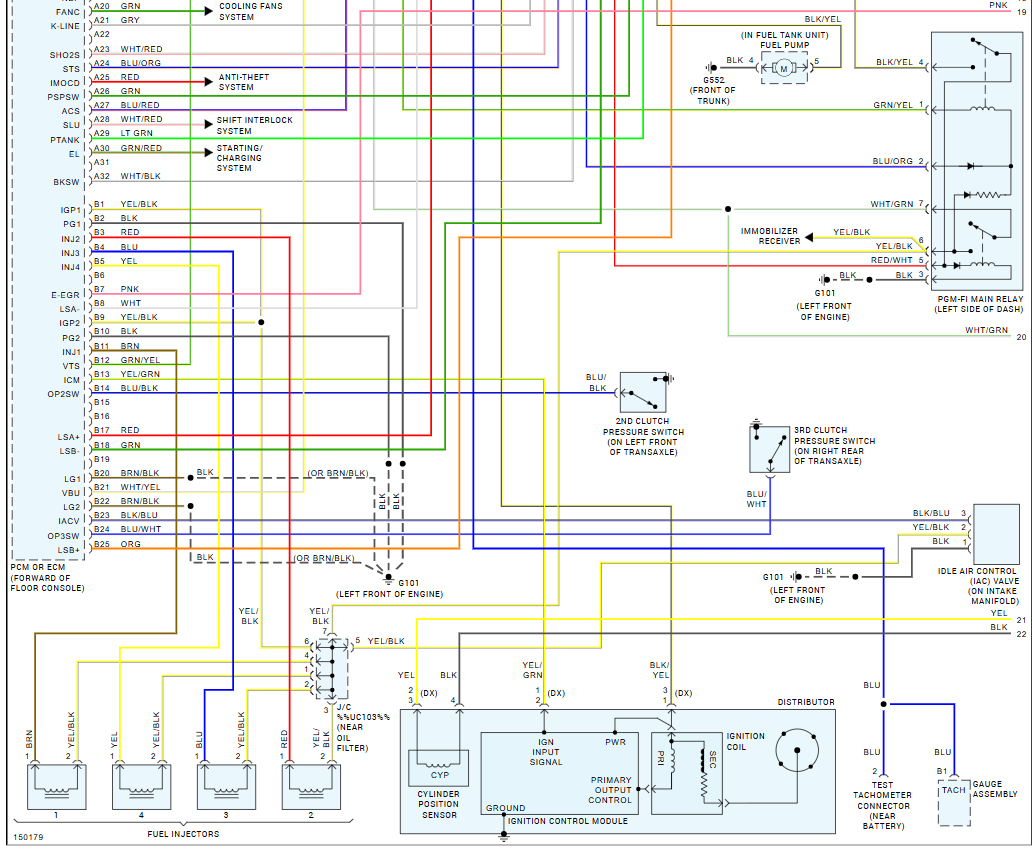

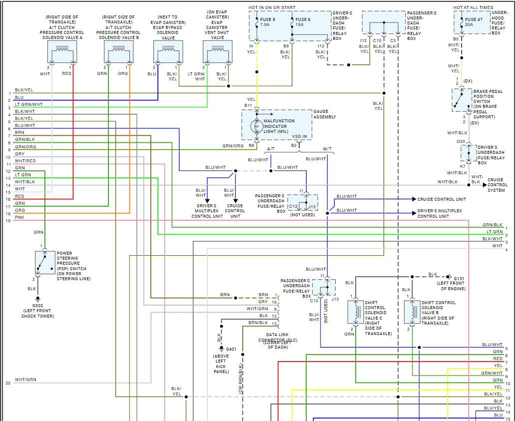

Could I get the wiring diagram for the engine?
2002 HONDA ACCORD
231,532 MILES • 2.3L • 4 CYL • 2WD • AUTOMATIC
BLESSING EWOBOR
  • 753 POSTS
The wire harness insulator is bad, the insulator is falling off gradually. The harness has been replaced but there is mixed up on the wiring with some components. Could I get the wiring diagram for the engine performance?
Feb 18, 2025 at 8:28 AM
  • 55,399 POSTS
Sure, here is a guide to help with the testing and the engine wiring diagrams for the 2.3 liter engine and computer.
Check out the images (below). Let us know if you need anything else.
