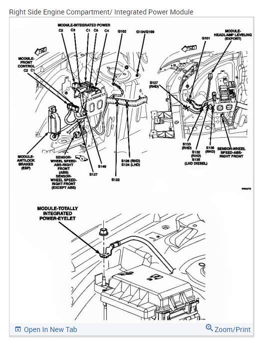

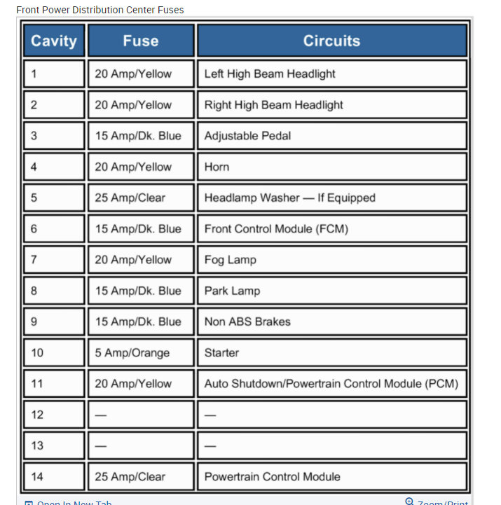

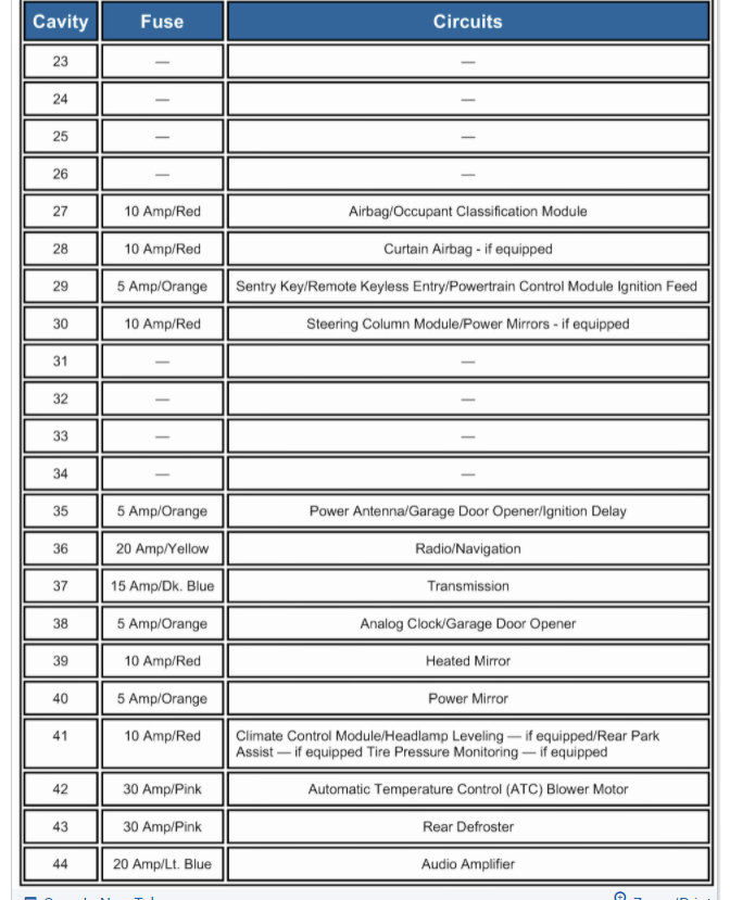

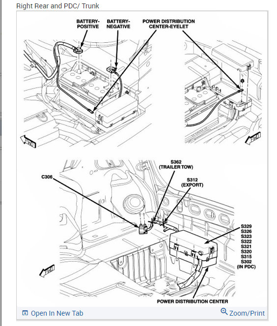

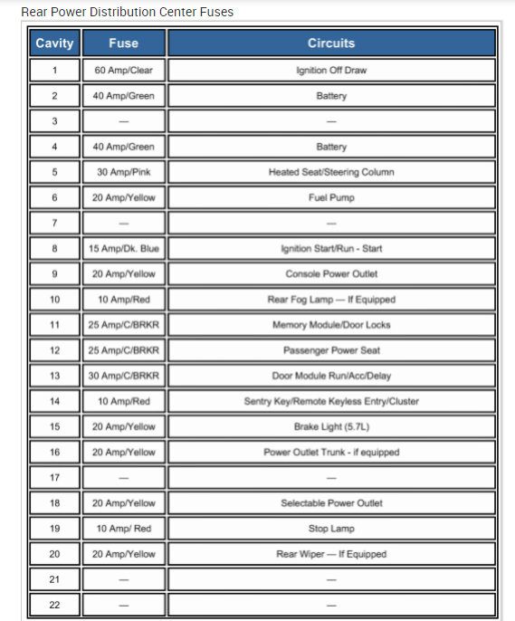

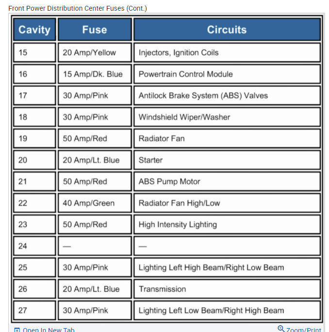

Here is a guide that will help with testing and replacing fuses:
Below you will find the info from the manual that will give the detail needed of the front and rear fuse blocks.
Please run through this material and let us know if you have other questions. Thanks
