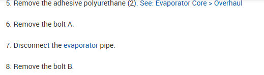

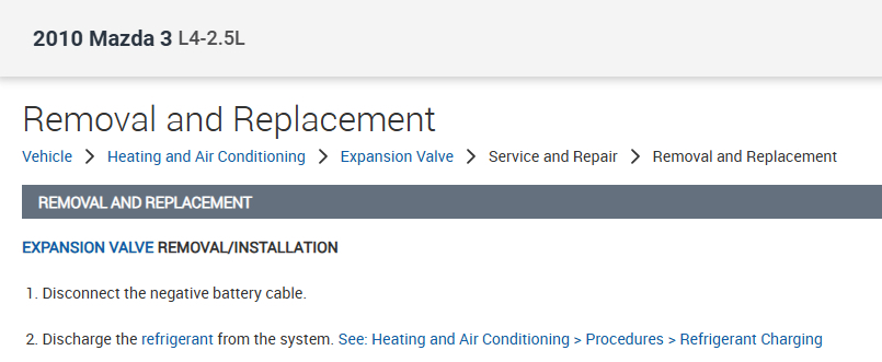

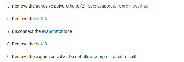

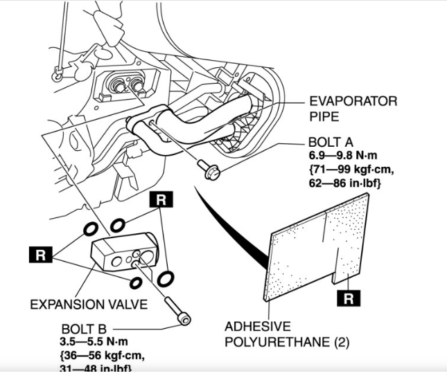

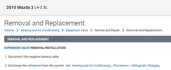

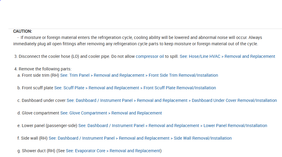

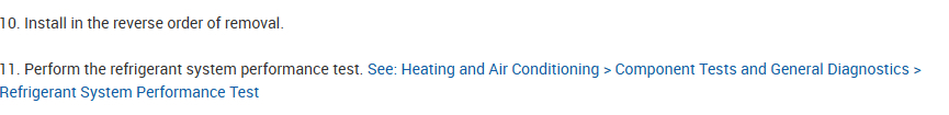

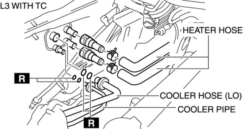

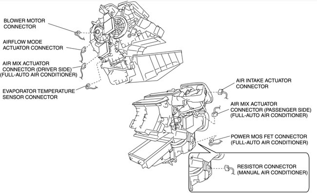

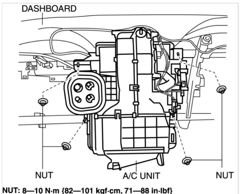

Hi:
I just looked it up and it appears to be under the dash of the interior. If you look below, I attached the directions from my manual.
Take a look at the directions and let me know if they are helpful.
See pics below
Jun 12, 2026 at 8:01 PM
  • 110,248 POSTS
Sorry, I attached the pics below. I accidentally hit reply before adding them.

  • 55,732 POSTS
Yep, I would start by removing the negative battery cable and then the steering column. This will give you a clear shot at removing the dashboard so you can get at the HVAC box. Also, drain the engine coolant because the heater hoses will ne dot be undone as well. This is a big job so take your time and upload any images of problems you run into and I will help walk you through them. Check out the images (below). Please upload an image or a short video in your response, so I can see what's going on.
