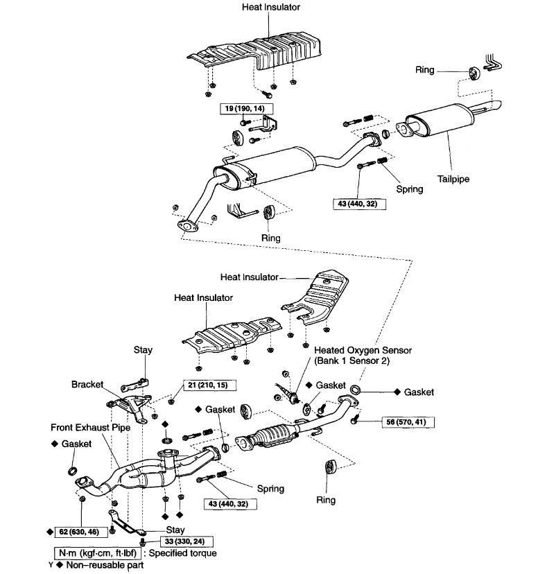

I am try­ing to find a di­a­gram / schematic of my vehicle listed above ex­haust sys­tem so i can pur­chase the cor­rect parts and try and fix it.

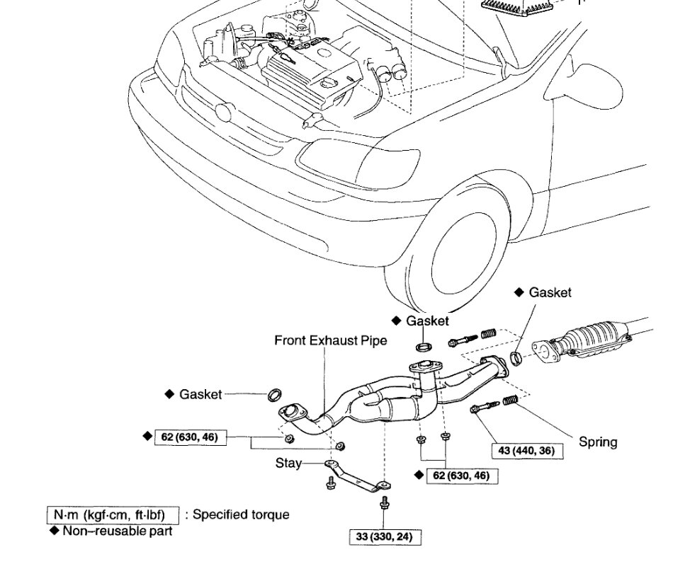

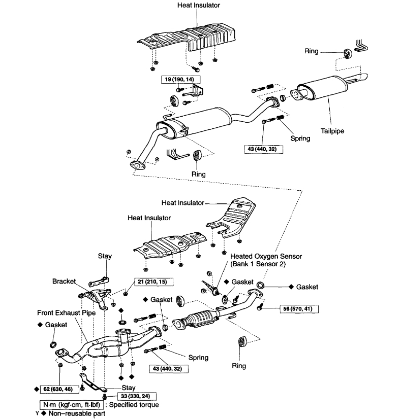

Sure, here are the exhaust system diagrams including the exhaust manifold and catalytic converter. Check out the images (below). Let us know if you need anything else.
