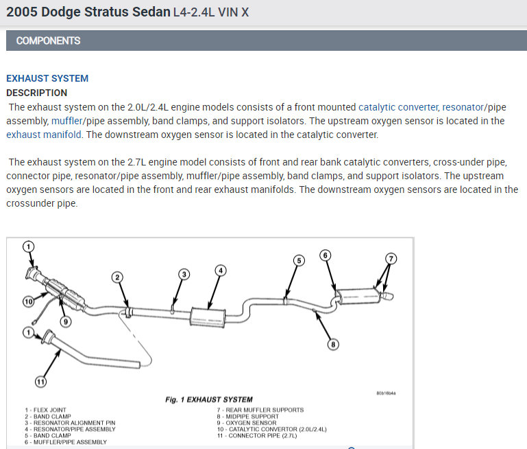

Can I get a diagram of the exhaust system?
2005 DODGE STRATUS
163,000 MILES • 2.4L
MICHELLE WIERSMA RUSH
  • 34 POSTS

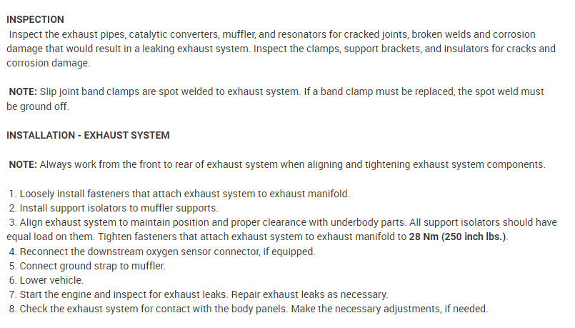

Can anyone tell me or show me a diagram of the exhaust system for my car listed above SXT sedan 16 cylinder 4.2L. X VIN. I know I have to replace catalytic converters, exhaust from block to muffler. cat came up on scan tool, the rest of the exhaust system is basically not there it has been rusted out in off including the whole bottom half with the muffler.

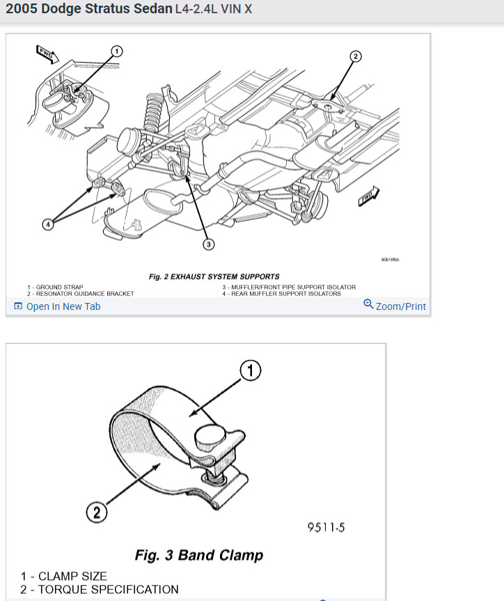

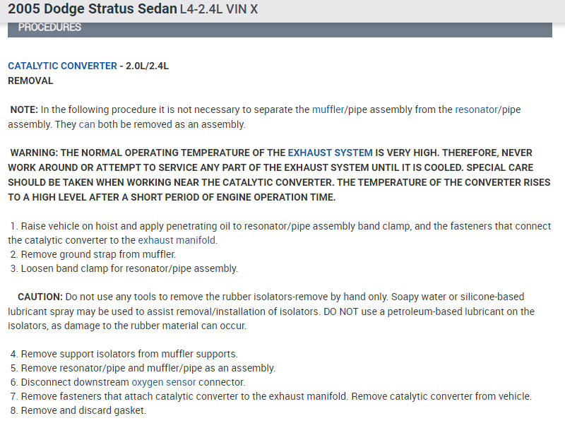

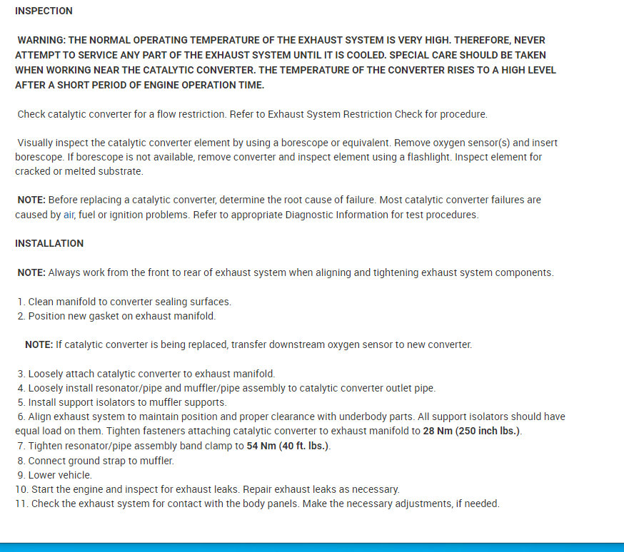

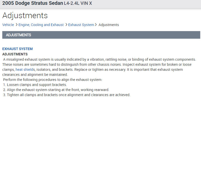

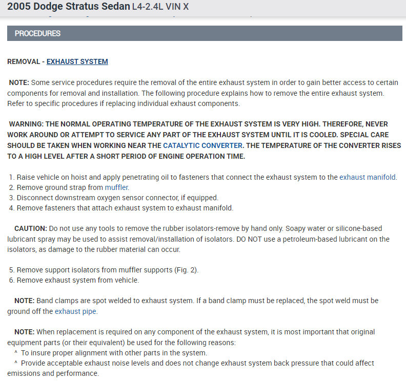

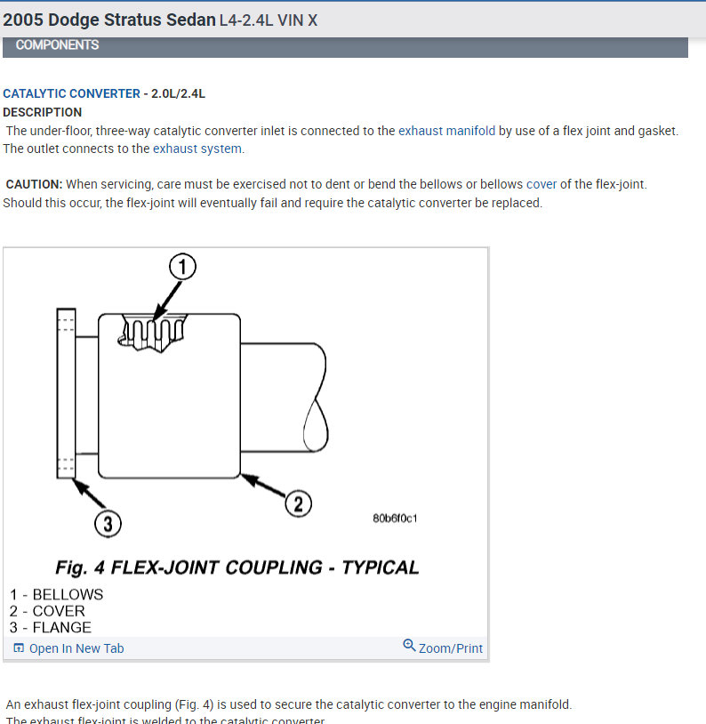

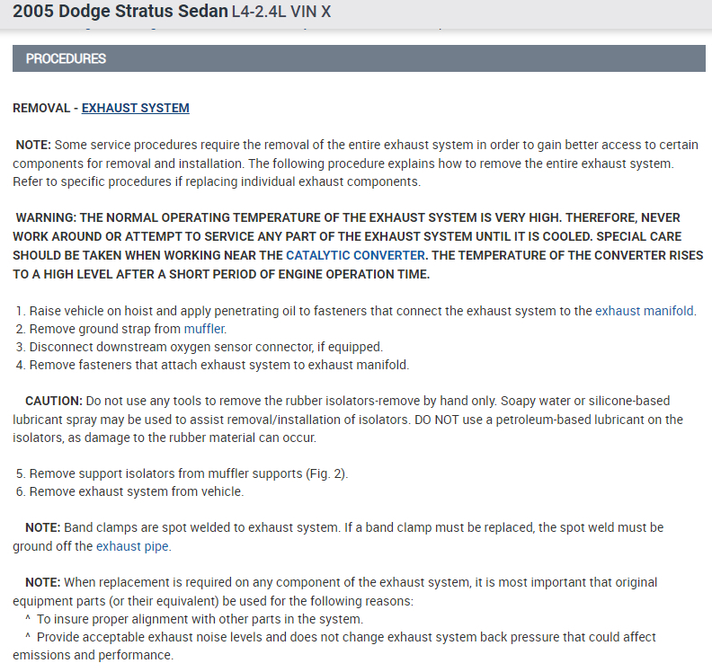

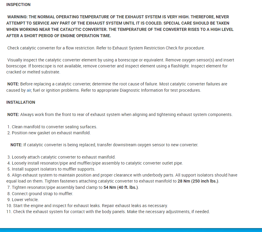

I have attached the diagrams for the exhaust system as well as the replacement procedures for your reference.
Here are couple of helpful articles on exhaust system:
https://www.2carpros.com/articles/exhaust-system-removal
