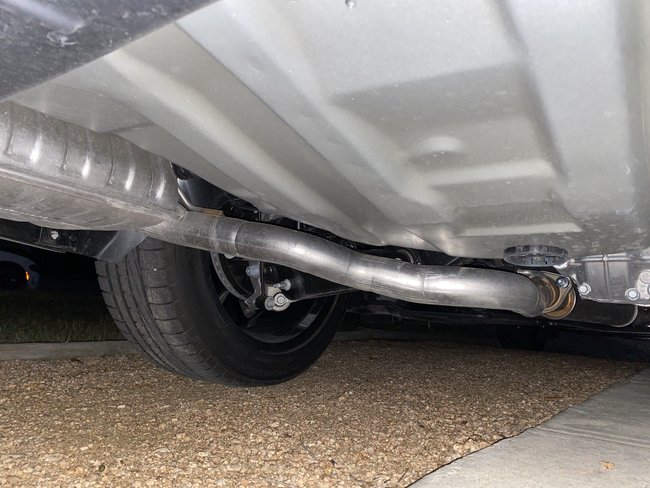

What is the stock size of the exhaust pipes, I would like to modify the exhaust?
700 MILES • 3.6L • V6 • 2WD • AUTOMATIC
BCHASSE99
  • 5 POSTS
I’m thinking 2.25. The car is brand new, and man does it have power for a V6. 0-60 in about 5.9 seconds but sounds like a baby, lol. I would like a deeper tone. I thought about doing a rear resonator deleting but fear I might get a drone sound. I have true dual exhaust with 2 4-inch tubular mufflers in the mid-section and two resonators near each back bumper. Would replacing the stock mufflers with Flow master FX be a good idea for a deeper but not fart can sounding option? I have a Hemi 5.7 Ram so I’m not trying to make it sound like a V8 just a bit deeper tone as it has the power already. Attached pic is the two front mufflers. Thanks

Attached are the current mufflers.

Back resonators.

Thanks for the images and video. The flow master FX is a good choice, but I would hang onto the stock mufflers because they are of a high quality. Please upload a video once the job is done so we can hear it. :)

Do you mean that I should replace the back resonators with the FX mufflers or simply keep the stock mufflers after removal? I think you mean hang on to the stock mufflers. thanks again

Yes, the rear resonators only but keep the stock ones because you might go back to them.
