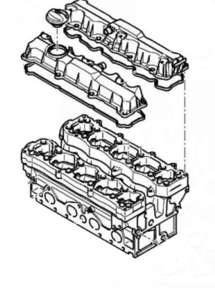

smoke coming from exhaust manifold when hot.

Hello, you most likely have an oil leak that's running onto the exhaust manifold. It's probably coming from the valve cover area. Although we don't carry these vehicles in our U.S. database, it looks like they have a split valve cover, two gaskets set.
