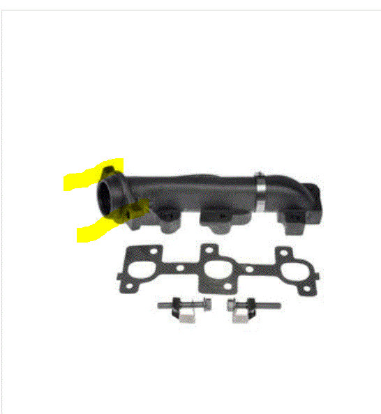

That is a good question. By chance, do you know if the flange in question is on the manifold or the Y-pipe?

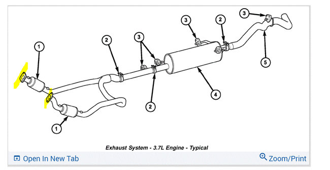

If you look at the pics below, I highlighted the flanges on each component. There are studs that thread into the exhaust manifold flange. On the opposite end, the Y pipe, there are flanges that will fit over the studs on the manifold and then a nut is used to attach them.
If the manifold threads are bad and the stud won't stay in, if there is room, you can simply get a longer bolt and nut to reach through the manifold and y-pipe. If it is the flange on the Y pipe, that is installed by the manufacturer before the converters are welded on, so that is more of an issue.

I will take pics tomorrow. If there studs on the y pipe are bad, will I need the c C while y pipe? Is there a catalytic converters connected or integrated in the y pipe?
Dec 5, 2021 at 10:17 AM
  • 110,240 POSTS
The converters, two of them, are integral to the Y-pipe. Also, I believe you are asking if the studs on the exhaust manifold are bad, will you need to replace the y-pipe. Is that correct?
If the studs at the manifold are the bad portion, the Y pipe may be fine. If the flange is bad on the Y-pipe, it will likely need to be replaced. However, I will check to see if there is something to repair it without replacement.
