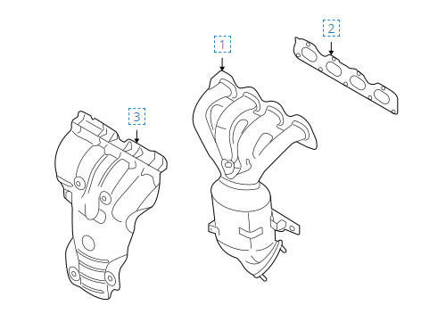

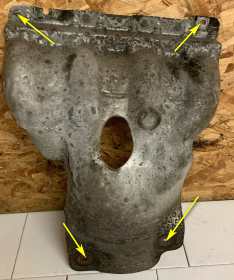

The heatshield is bolted to the exhaust manifold, see image below. Yellow arrows point to bolt holes.
Also see exploded view, image 2. The heatshield is no. 3.

Thanks so much for it. I might just replace it. Does the newer shield have to be welded onto the exhaust pipe on the bottom of the shield? There were bolts on it before but it looked like it was welded on by the factory.
Apr 12, 2022 at 12:14 PM
BORIS K
  • 836 POSTS
The heatshield is only bolted on as it needs to be removable for maintenance access.
