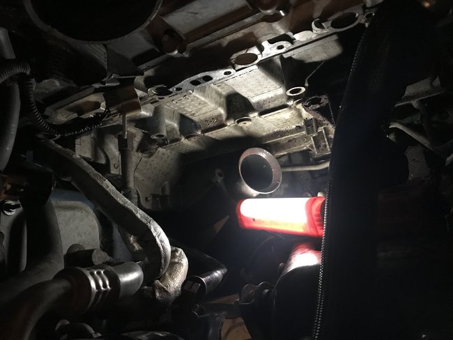

This was our vehicle originally, our son owns it now. Cracks developed in the exhaust manifold. He was able to remove the manifold; however, numerous bolts were broken even before the removal. Can you recommend specific extraction tools, techniques, insight he can use in removing the studs in the block on this specific 4.2L six cylinder engine?

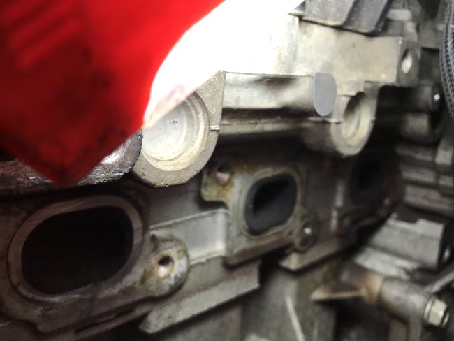

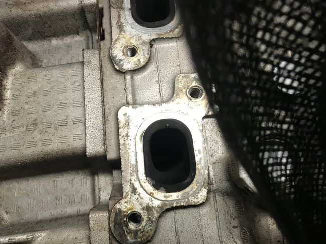

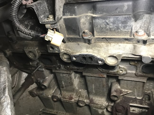

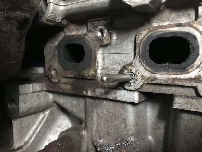

Here are the pictures:
Dec 19, 2019 at 10:42 PM
I only see 2 broken bolts.
The one with the easy out, did you heat up the area with a torch to see if you can extract it?
Dec 20, 2019 at 9:03 PM
SIRJR
  • 86 POSTS
I know he hadn't used any heat in trying the extraction. Could you explain the correct procedure using heat to remove the broken bolts in the block. Thank you.
Dec 22, 2019 at 4:46 AM
You need a torch and heat up the area around the broken bolts. The aluminum will expand and release the bolts so they can be extracted.

Finally able to sit in front of computer. We will heat the area up first as you stated. Regarding drilling out the center of the broken bolt, should we use a left drill bit instead of the standard drill bit? If so, where would you recommend to purchase? Regarding bolt extractor; what brand should we purchase, as I do not want to purchase Harbor Freight quality for this job. Also, do they make short versions of bolt extractors as the bolt closest to the firewall does not give us a lot of working room. All your recommendations are welcomed. Thank you, Steve
Dec 27, 2019 at 9:18 AM
Use regular drill bits. I found the ones made by MAC tools work the best.
The easy outs are left threaded for removal once it is heated up.

Conclusion and update. We were unable to remove the broken exhaust manifold bolts with the head on the block. We had to remove the head from the block; unfortunately, 13 of 14 head bolts snapped. This was even after "shocking" the bolts with a hand impact driver. In drilling a pilot hole with a left drill bit to use the bolt extractor, the broken ends of the bolts all screwed out just using the reverse drill bit. Two of the broken head bolts came out easy; the two we tried to extract on the vehicle wold not move, even with heat. We would up drilling them out and used a heli-coil kit. After bolting the head back to the block, we put the gears back onto the cams and everything lined up perfectly and the cam cover was re-installed. I had to leave to return to Florida at this point. My son bolted the new exhaust manifold and connected everything else that had to be removed. Four days after I left, he faced timed me as he was going to start the vehicle . It started up perfectly, not one trouble light ( check engine, etc.) came on. he drove the vehicle a mile that night. That weekend he drove it approximately 35 miles with out any issues. The oil (and filter) was changed twice. The vehicle has approximately 350 miles on it since and is working great. He is looking forward to passing the 200,000 mile threshold this year. Thank you for your insights to this project; I'm appreciative for 2CarPros!
