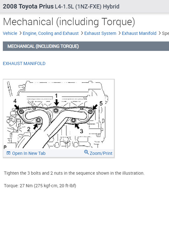

What brand of drill bit to remove the exhaust manifold bolt?
2008 TOYOTA PRIUS
240,000 MILES • 1.5L • 4 CYL • 2WD • AUTOMATIC
JAKEM1994
The exhaust manifold bolt I’m trying to remove, and I was wondering what exact brand of drill bit. Do I get to drill through the broken bolt I’m going to get at Home Depot?
Apr 22, 2022 at 9:58 AM
SQM
  • 6,383 POSTS
When you get the drill bit you want to make sure it is made for drilling into metal. As for the brand there are few good choices, Dewalt or Milwaukee makes quality drill bit and can be found at Home Depot.
Here are couple of helpful videos on drill out bolts:
https://youtu.be/YDt5OUIZTs0
https://youtu.be/py-rIWATchY
Let me know of any questions.
