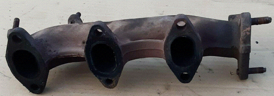

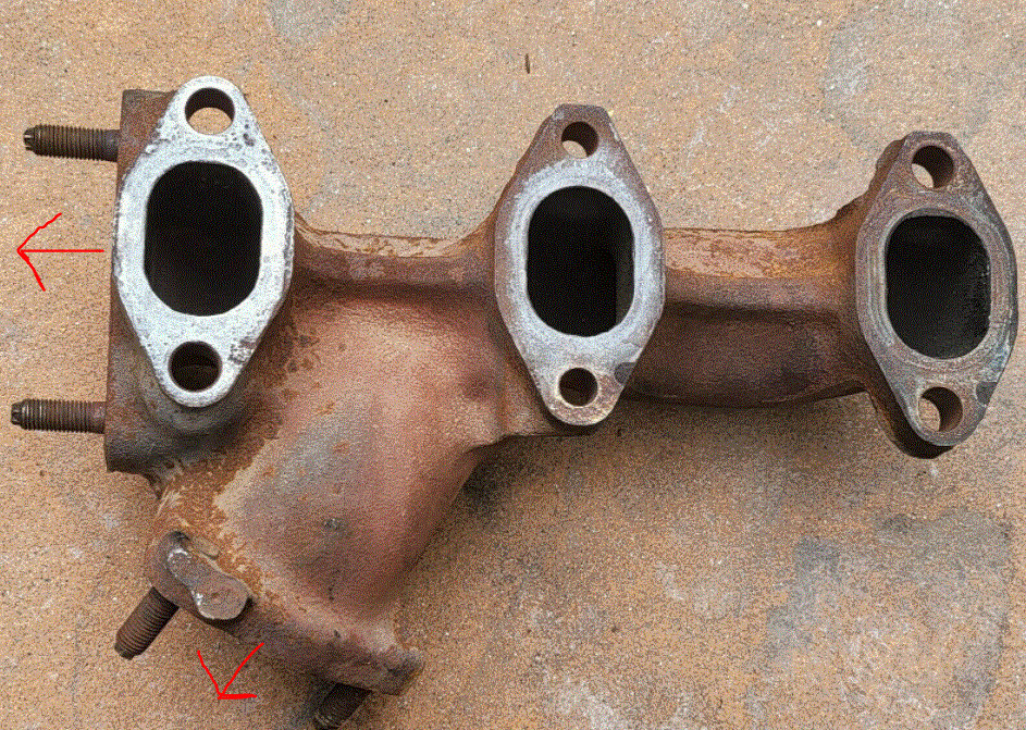

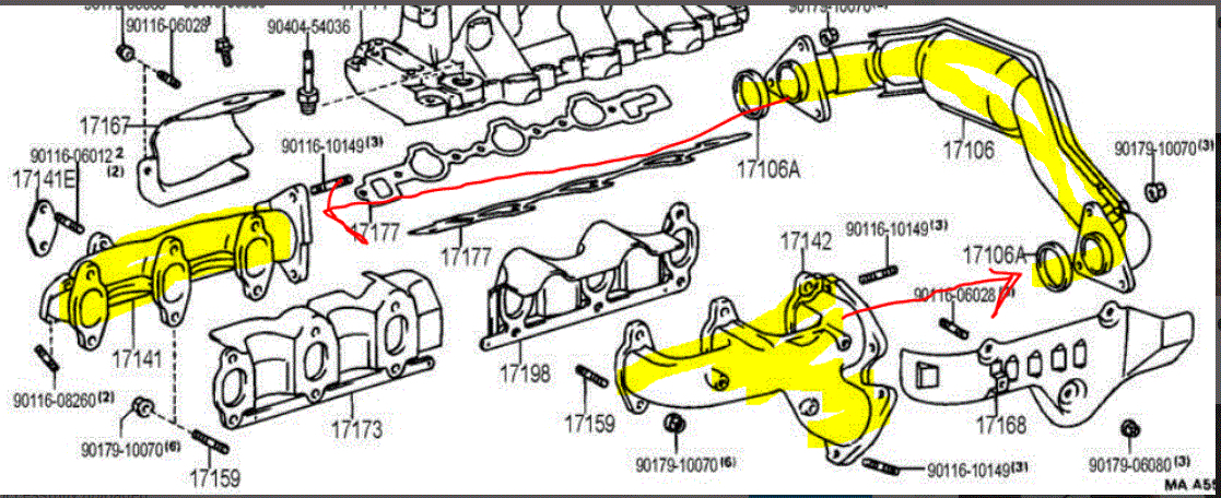

I have an air leak from the exhaust manifold and what is the bolt pattern for the manifold?

I'm not 100% sure what is needed, but I will try to explain how the system is put together.
There are two exhaust manifolds, one on each side of the engine. The two are joined together via a crossover pipe that runs behind the engine.
I'm not sure where you hear the leak, but it could be between the two manifolds where the crossover pipe is located.
Pics 1 and 2 are the manifolds. Pic 1 is the driver's side and pic 2 is the passenger side. The third pic is an exploded view, and I highlighted the cross-over pipe. Note that the driver's side has two outlets. One is for the cross over and the other attaches to a downpipe for the exhaust.
You can see the bolt patterns in the pics.
