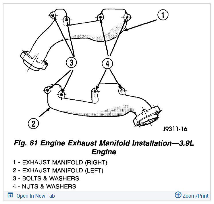

I'm wanting to look at changing the exhaust manifold gaskets since it looks like it's separated from the surface. Does it cause a noise like a hum noise as your driving that seems louder, and you go faster or give gas? I also am still losing oil somewhere and at one time a code in sufficient on exhaust (can't recall code way BK but reset and went away. likely caused from sitting at lights).
Is that one of the common sounds when a leak is present? There's no ticking.

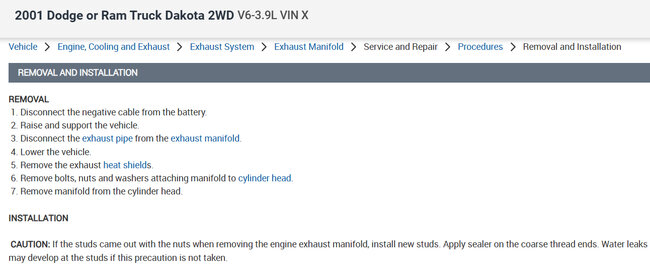

Also do I have a few bolts that have nuts holding the exhaust cover on studs? And what technique besides using heat. would warming engine help? I don't have a torch but a heat gun. Hopefully a few use nuts, not bolts too.
Thanks

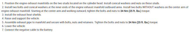

If you upload a short video of the noise, I can tell for sure what's going on. Here is a video that will help you if you break one of the exhaust manifold bolts and I included instructions on how to remove the exhaust manifolds as well.
https://www.youtube.com/watch?v=py-rIWATchY
Please start a new thread for the oil leak problem. Sorry, we only handle one problem per thread, please post your new question here, you must be logged in.
Check out the images (below). Please upload pictures or videos in your response of any problems so we can see what to help you with.

What technique helps to loosen bolts? I sprayed it a few days ago when warm. Will try again in morning. Is it too risky to use an air tool to loosen? Because of the high chance of break. can I leave studs in on 2 of the 4 and just remove nut?
I can't drive it right now, but I will try to get a pic where gasket is separated.

Yep, I would use wd40 overnight and then use a high-quality socket or wrench to help loosen the bolts, I would loosen, then tighten a little and then loosen to help the bolts come out. I would use air tools as a last resort. Check the video in the post above in case you break one.
