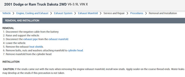

I'm wanting to look at changing the exhaust manifold gaskets since it looks like it's separated from the surface. Does it cause a noise like a hum noise as your driving that seems louder, and you go faster or give gas? I also am still losing oil somewhere and at one time a code in sufficient on exhaust (can't recall code way BK but reset and went away. likely caused from sitting at lights).
Is that one of the common sounds when a leak is present? There's no ticking.

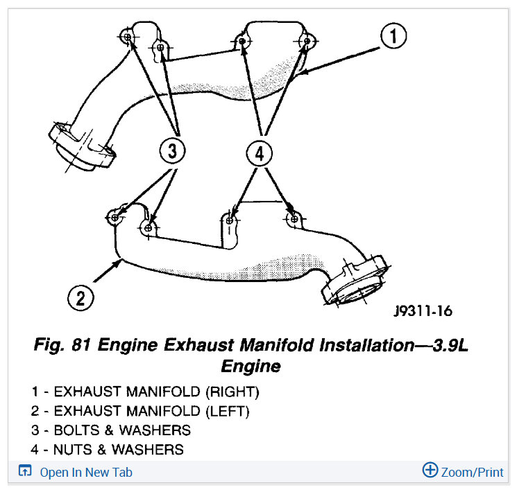

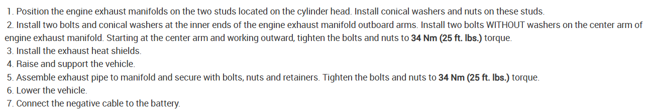

Also do I have a few bolts that have nuts holding the exhaust cover on studs? And what technique besides using heat. would warming engine help? I don't have a torch but a heat gun. Hopefully a few use nuts, not bolts too.
Thanks

If you upload a short video of the noise, I can tell for sure what's going on. Here is a video that will help you if you break one of the exhaust manifold bolts and I included instructions on how to remove the exhaust manifolds as well.

What technique helps to loosen bolts? I sprayed it a few days ago when warm. Will try again in morning. Is it too risky to use an air tool to loosen? Because of the high chance of break. can I leave studs in on 2 of the 4 and just remove nut?

Yep, I would use wd40 overnight and then use a high-quality socket or wrench to help loosen the bolts, I would loosen, then tighten a little and then loosen to help the bolts come out. I would use air tools as a last resort. Check the video in the post above in case you break one.
