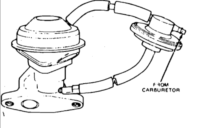

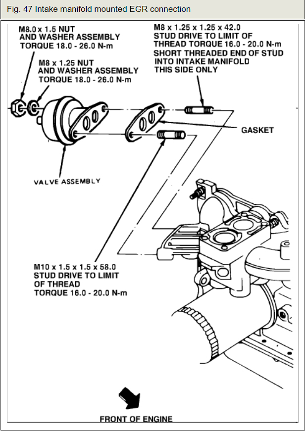

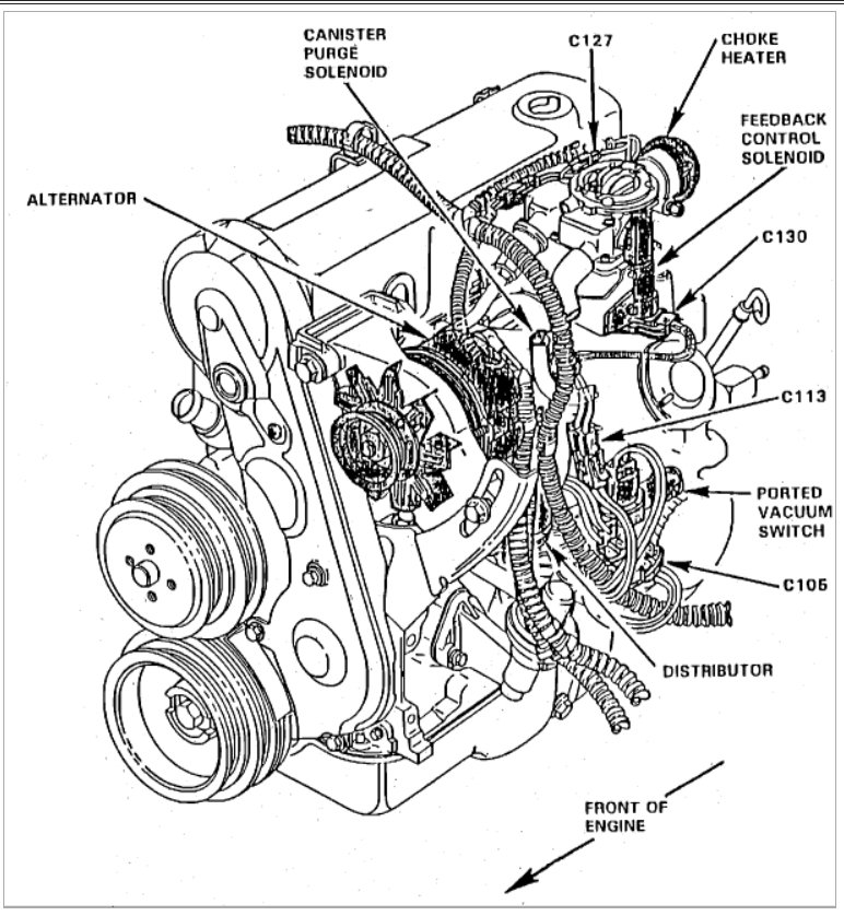

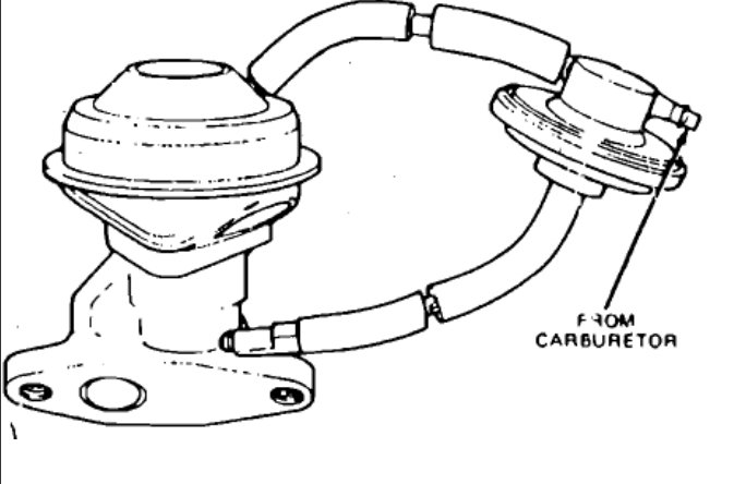

where can i find the piece that connects the EGR tube or the cross over tube that runs from the manifold over to the exhaust manifold? it is a piece that screws into exhaust side and then tube screws into it.
Feb 5, 2018 at 7:09 AM
  • 55,238 POSTS
There is an EGR tube and fitting which I think is what you are wanting to know. Here are some diagrams to help you see what you are looking for.
