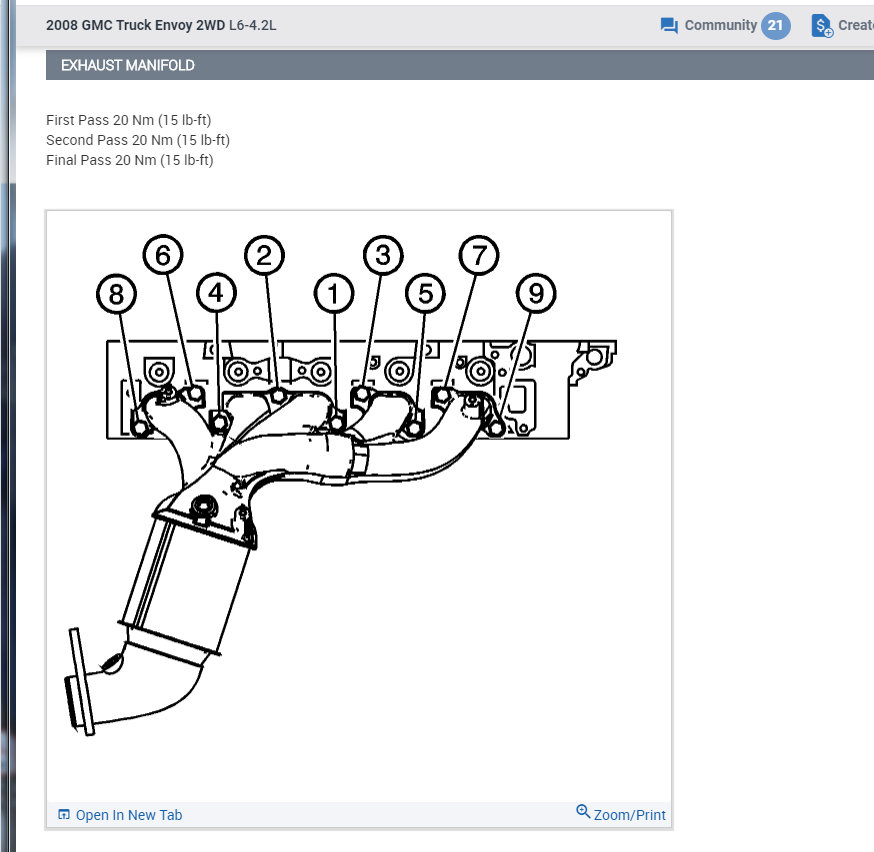

Just need to know the torque specs for the exhaust manifold bolts.
Oct 18, 2020 at 8:59 AM
I attached the 3 pass spec and progression. Let us know if you need more info. Check out the diagrams (Below). Please let us know if you need anything else to get the problem fixed.Thanks
