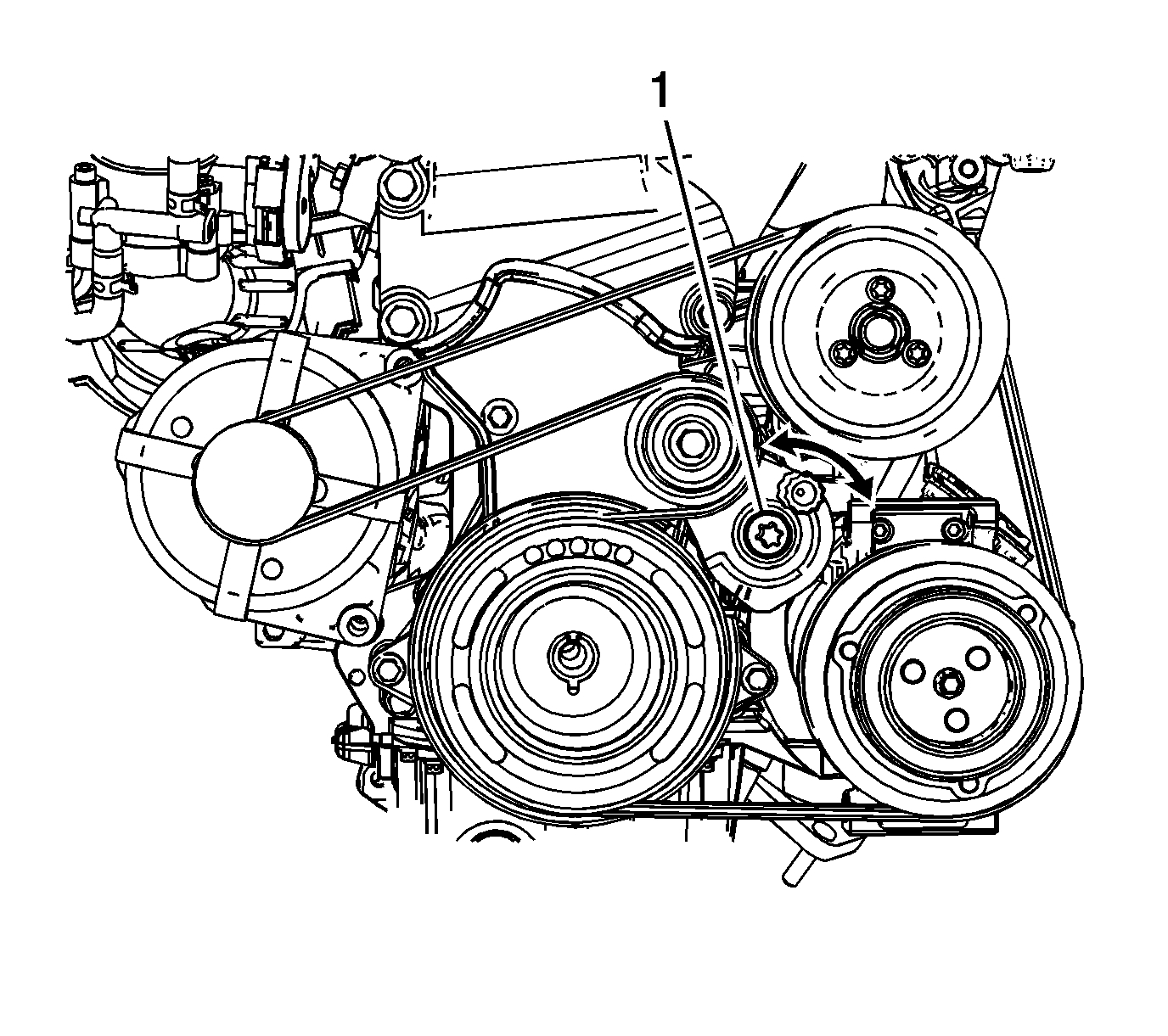

I had a feeling it was something that was driven by the accessory drive belt. I don't know if you had them replace it or not, so I am going to add the directions in case you still have to do it. The attached pictures correlate with the directions.
_____________________________________
REMOVAL AND REPLACEMENT
Drive Belt Tensioner Replacement
Removal Procedure
picture 1
Note: To remove the power steering pump belt, do remove the accessory belt in advance.
1. Rotate the tensioner star-nut (1) and remove the accessory belt.
2. Remove the power steering belt. Refer to Power Steering Pump Replacement (1.2L LMU Engine) (See: Power Steering Pump > Removal and Replacement > Power Steering Pump Replacement)Power Steering Pump Replacement (1.4L L95 and 1.5L LV8 Engines) (See: Power Steering Pump > Removal and Replacement > Power Steering Pump Replacement)Power Steering Pump Replacement (1.4L LDT and 1.6L LXV Engines) (See: Power Steering Pump > Removal and Replacement > Power Steering Pump Replacement).
picture 2
3. Remove the accessory belt tensioner (1).

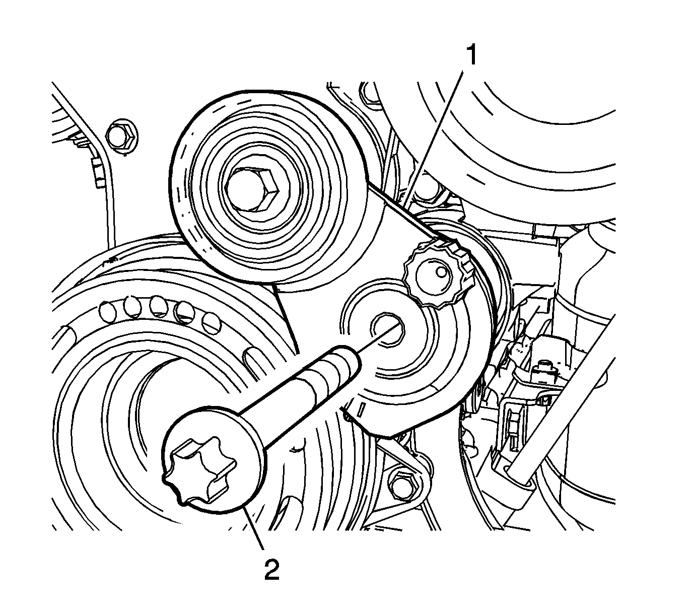

Installation Procedure
picture 3
Caution: Refer to Fastener Caution (See: Vehicle > Vehicle Damage Warnings > Fastener Caution).
1. Install the accessory belt tensioner (1) and tighten to 50 Nm (36.8 lb ft).
