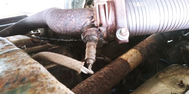

Thank you so much. I was going to clean the MAP sensor so. I will definitely check that out. Also I noticed I can see that 02 Sensor and I don't think I'm supposed to be able to see it clear as day it looks like maybe someone just wired it in and clamped or attached it right there. Thanks to you guys I'm getting closer. Unfortunately it's dark here now. Tomorrow is another day. Ill try to remember to take a few pics. Also my muffler and tailpipe are fine. I inspected them. I'm thinking the leaks are either in the clamps or someplace on the flex pipe or closer to manifold I'll know more tomorrow. Have a great night.

Well, I didn't get much done today but I did check the entire exhaust out. I'm pretty sure the O2 sensor is not supposed to be just hanging there and it's rough looking. Two pieces of flex pipe a few holes by the clamps. The rest of the old pipes going to muffler, the muffler itself and the tail pipe are fine. I have an O2 sensor I have a new MAP Sensor I'm going to get the left and right front pipes and a converter online for around $300 New.. I am up loading a pic of that O2 sensor because I know its not supposed to look like that and out in the wide open like that I'm not sure but it doesn't look good to me. I checked the hose by map sensor for leaks. That sensor looks raggedy also. Ok I sure hope I'm on the right track. Maybe I can pay my brother to put that exhaust together once I get parts.

The o2 sensor is bolted into the exhaust and will be exposed as in the pic. However, it looks like it may have been welded on the one side. If it is, that's going to be a problem because you won't be able to remove it.

  • 110,194 POSTS
Honestly, I would recommend it. From what I can tell, someone used a generic type flex tubing to repair behind the sensor. It's really hard for me to tell simply because I'm not there.

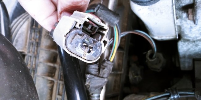

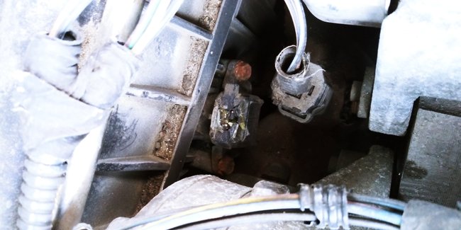

Oh boy. I finally went out to at least find and clean MAP Sensor I can't believe what I found. I'm adding pics. Now what. I can't even get old one out before dark to replace it and I have to drive 4 miles one way and back in the am. I promised a State Cop I'd sit with her dad while she goes to church. I don't know her but we have a mutual friend who asked me and there is no one else to go out there. Will driving 8 miles hurt this? I think that is the MAP Sensor. I finally got a repair book for this.
Mar 13, 2021 at 2:52 PM
  • 110,194 POSTS
It won't run properly, but it shouldn't really hurt anything. Try to clean it up as best you can.

Well, it took about 2 hours to get the one half of broken sensor out of the harness and to use an 8mm hand wrench to turn the 2 tiny bolts holding the other half of MAP sensor 1/4 turn at a time. I was ready to scream. Now tomorrow I'll just put the new one in. Yeah, hopefully the bolts will go in quicker than they came out. Thanks so much.

Okay, so 6 hours later the new MAP sensor is in. Both the Map sensor and O2 sensor codes are gone and the check engine light is off. I will clean that new MAP sensor every so often because I don't ever want to have to work in that tight of a space again, Lol. Thank you for all of your support and answering my questions. Glad I changed the MAP Sensor before the O2 sensor because the one took care of both. I guess things aren't always what they seem to be and that's why you are a mechanic and I'm not. Hope you have a great day!

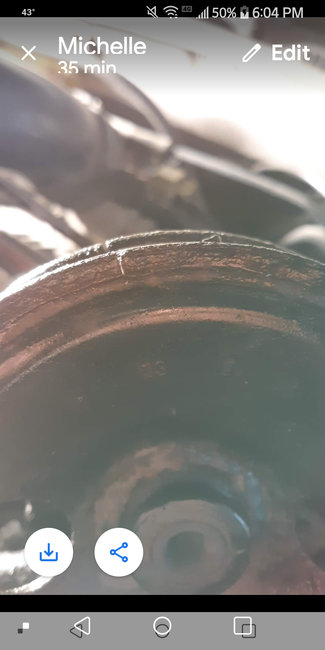

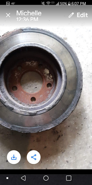

Okay, so I bought the two catalytic converters tailpipe and muffler. The y pipe is okay because the estimate I got at a local shop just had the converters tailpipe and muffler listed in their estimate. I found and bought the exact part numbers and am having that put on hopefully tomorrow after the powers steering pump is finished. Today it was front and rear brakes and power steering pump. I left replies for that on one of my questions about tires feel funny.and my power steering question. Along with a gouged rotor and brakes put on backwards. I know this guy buys and sells cars all day long but I don't think he should be because who puts brakes on inside out or backwards and that rotor had a huge gouge on the inside. Well at least with all repairs it should last a few years with maintenance.
Apr 16, 2021 at 3:21 PM
  • 110,194 POSTS
I have no idea how the brakes were put on backward. Ugh!!! That means the steel backing plate on the brake pad was stopping you. No wonder the rotor was bad.

Thanks at least it's all getting done. And done correctly. I'll post pics of my new exhaust. I did get a new O2 sensor the other one was welded to the flex pipe. Yeah, I had to get a new pulley as you can see the other one needs replaced in the pic and yeah that rotor. I knew there was something I just couldn't put my finger on. My brake pedal didn't feel right. I was going to bleed them then that rotor was found. Thanks for everything.
