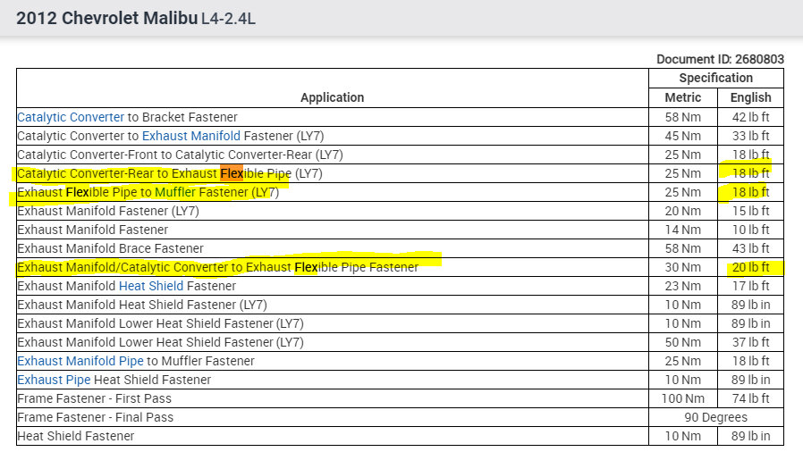

When you install the new ones, is there any rust or damage at the flange where the gasket sits? Also, make sure the flanges are flat and not warped.
I attached the torque specifications below. Tighten them to this specification. If it is too loose, that can cause it to fail. Also, if anything appears to be warped, try using two gaskets.
Let me know if this helps.
See pic below.

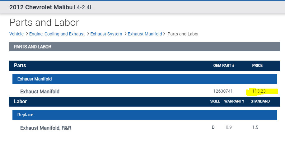

Wow, if two gaskets won't work, they must be warped badly. Before you go crazy trying to find someone to machine a flat surface, price a new part. I suspect the cost will be very similar. I just looked up the price for a new manifold (I suspect that is the part that is warped). The OEM part is 113.00. I suspect you will have that in repairing the original one.
It's just a thought.
Let me know if I can help in any way.
joe
See pic below.
