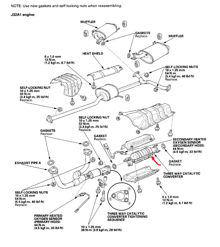

How many catalytic converters does my car have? What do they look like with this make and model and where are they located?

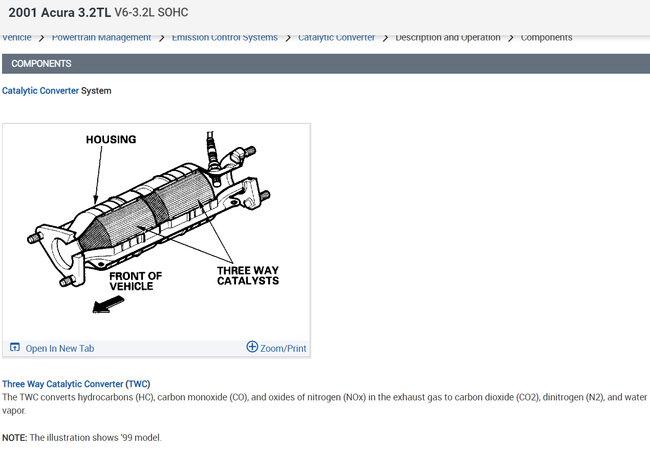

It looks like just one, there are no cats in the exhaust manifolds so that is good. Here are images to help you see for yourself. Check out the images (below). Let us know if you need anything else.
