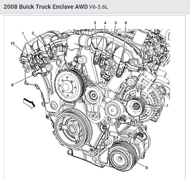

Where is the driver side exhaust camshaft position sensor located?
2008 BUICK ENCLAVE
206,000 MILES • 3.6L • 6 CYL • 4WD • AUTOMATIC
ERICFT
Having trouble looking for the driver side location of the exhaust camshaft position sensor.
Aug 27, 2023 at 7:38 AM
  • 110,240 POSTS

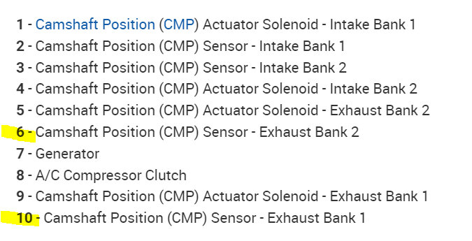

I attached two pics below. The first one identifies different sensors including the camshaft position sensors. Pic 2 is the legend for pic 1.
From memory, the driver's side is bank 2. I believe that is the one you are looking for which is identified as number 6 in the picture.
Take a look and let me know if it helps or if you have other questions.

Thanks a bunch! This helped figure it out :)
