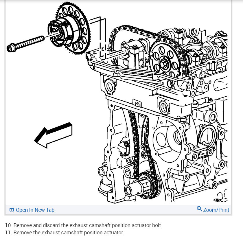

Had issues with Hummer where cylinder 3 bad. GM repaired issue and warranty paid for labor and replacement of cylinder head. GM says when they started it up it made a "horrible noise" and investigation found noise from timing belt because Exhaust Camshaft Actuator bad. GM says wear and tear could cause, warranty will not pay. $1,000.00 or so for fix. What would be the indication that this part was going bad? Could an error in reassembly cause this part to go bad?

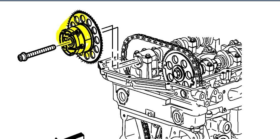

Did it make noise prior to the repair? If not, then other than a check engine light indicating a timing issue, you wouldn't have known. As far as putting it together, the only thing I can think of that could be causing it to make noise was if the actuator wasn't fully advanced when it was installed. I would think that is unlikely if it is a dealership but anything is possible.
If you want to replace it yourself, let me know and I'll tell you how. It isn't the easiest job and does require a fuel special tools, but it can be done at home if needed.
I attached a picture of the actuator so you can see what it is.
Let me know if I can help.

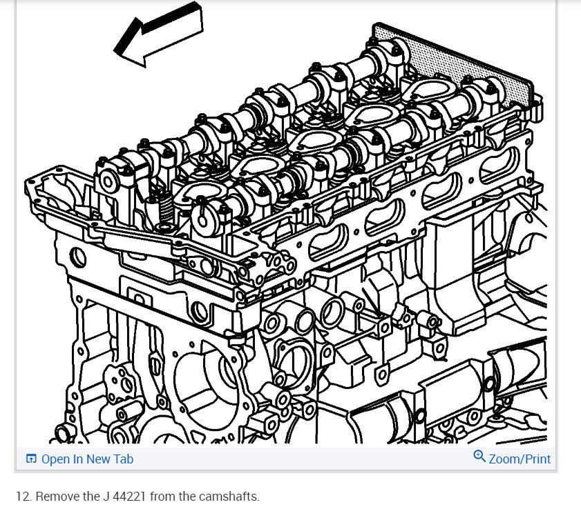

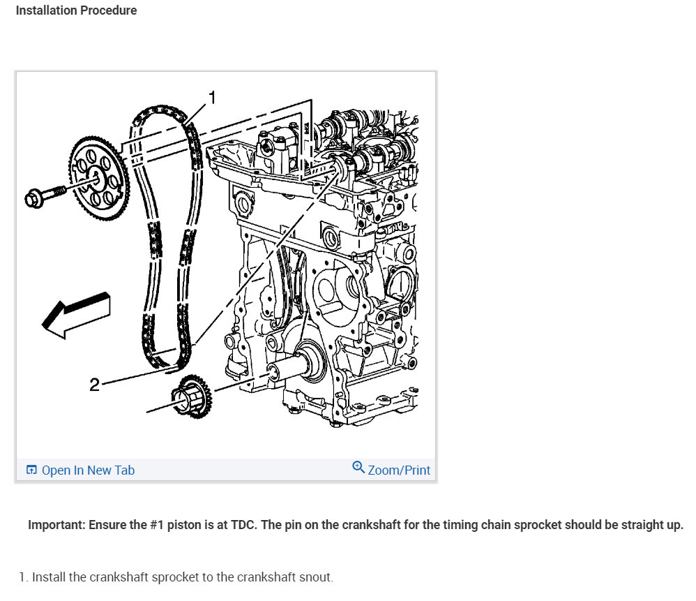

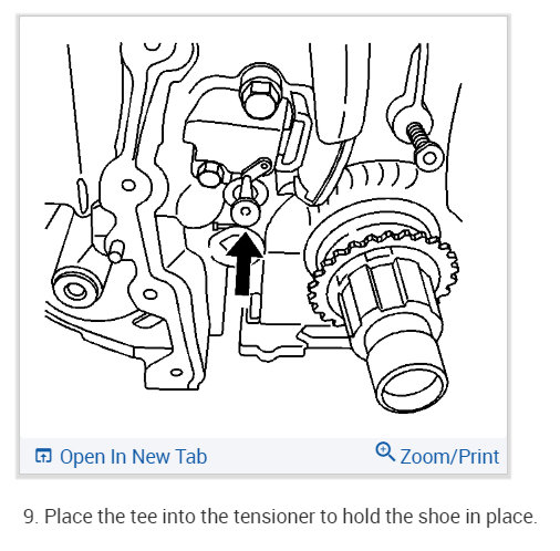

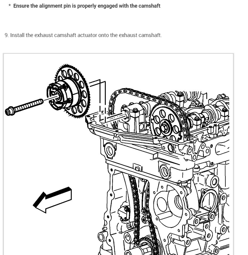

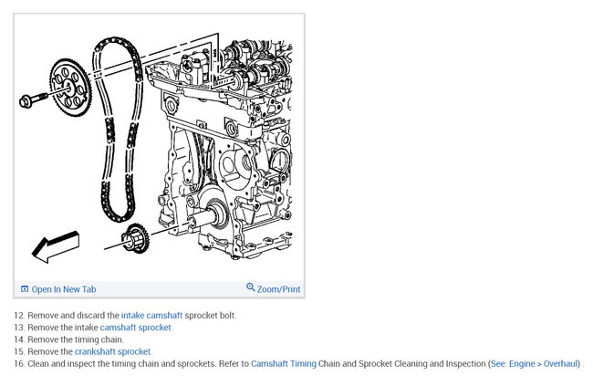

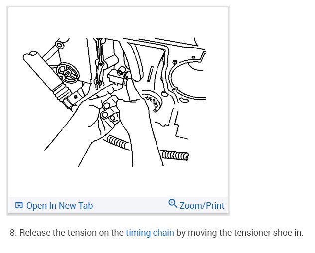

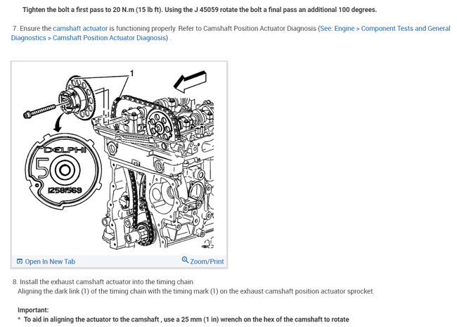

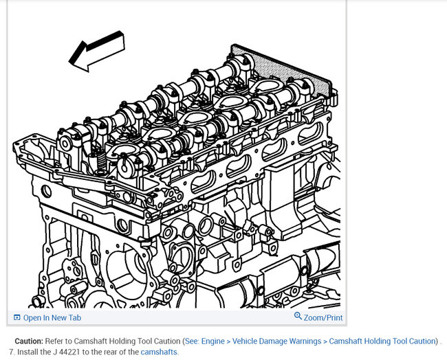

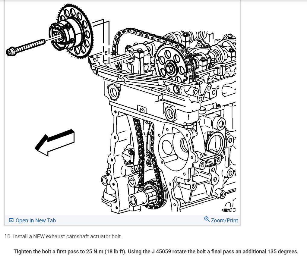

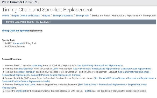

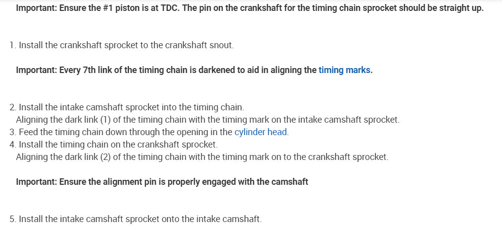

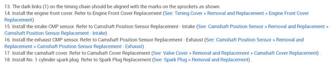

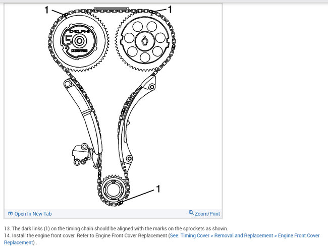

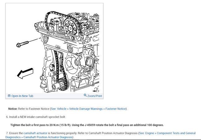

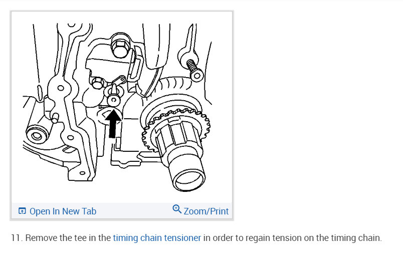

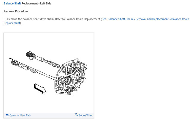

Hmm, It does sound like they messed something up which happens. Can you please shoot a quick video with your phone so we can hear the noise? that would be great. You can upload it here with your response. Here is the correct way to install the timing chain and actuators. Also these engines have balance shafts which have problems that make noise as well. Check out the diagrams (below). Please let us know what you find. We are interested to see what it is.
