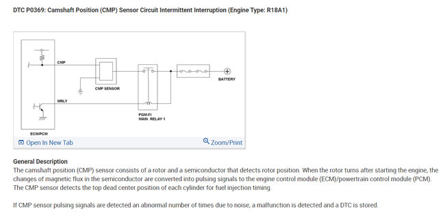

my cars check engine light when on, code p0340 the camshaft code.... its been running rough, it jerks on first gear, sometimes the transmissions feels harder, and occasionally it takes 2-3 tries to turn on. Anyways I bought a sensor on A1 auto and I installed it but the car cranked but did not start with the new sensor. I put the old OEM sensor back in and it started fine. did I not install the sensor right? could the part be defective? I did not lubricate the new sensor when I inserted it.
Oct 24, 2018 at 7:49 PM
Good morning,

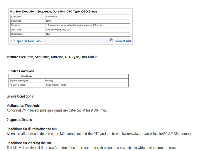

Yes, it sounds like you either have a bad new sensor or the connector is damaged. Make sure the connector is clean and there is no damage to the ends. Check for corrosion.
I attached the flow chart for the cam sensor as well for you to follow.
https://www.2carpros.com/articles/camshaft-angle-sensor-replacement
