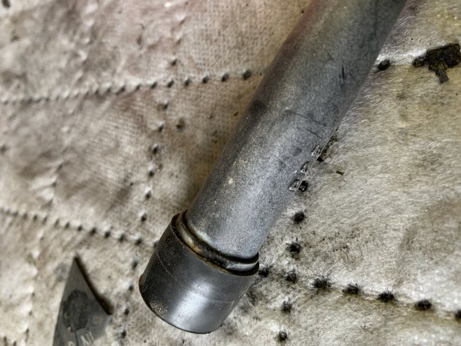

Started up my car drove to work no problem. Leaving work I hear a sound like an exhaust leak I know it’s there it’s been there for a while but I can see the exhaust leaking from under the middle of the car. But now when I accelerate just slightly step on the pedal it runs rough and a lot of exhaust noise. I get underneath the car I checked everywhere in the front by the headers sounds OK there’s a strange exhaust sound coming from the catalytic converter but I feel no leak. The only leak I feel is after the resonator from the resonator connection to the secondary pipe to the muffler. I can understand if there’s an exhaust leak in front of the cat That would make the engine run rough because there’s no back pressure but I don’t feel or hear any exhaust in that area leaking. Can my cat go bad and not leak?

Okay, so I took it to my mechanic and the leak was coming from the engine pipe like the header pipe so we changed from the catalytic converter back everything. But now I have a misfire in the number five cylinder. Can the exhaust leak affect the plug on that cylinder? I just changed the ignition modular wires and plugs about six years ago. So I’m a little concerned. I don’t see the ignition modular going that quickly. On top of that the number five cylinder is under the intake manifold. Any suggestions?
Friday, January 24th, 2020 AT 11:40 AM
The leak itself will not cause an issue but if this is before the o2 sensors then it can effect the air/fuel mixture. Basically the PCM thinks the exhaust has more oxygen in it then it should so it richens up the fuel mixture. However, it doesn't enrich just one cylinder. It will effect all cylinders.
If you have changed the plugs in 6 years then we should go ahead and do that and see what the plugs look like. I suspect they are going to be fouled and if they are, maybe number 5 was just further gone then the others and replacing them will correct it.

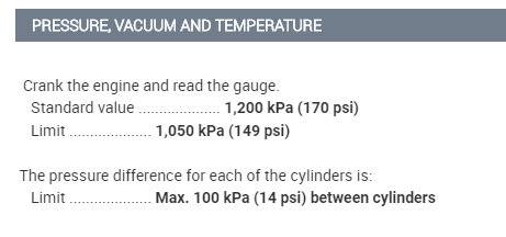

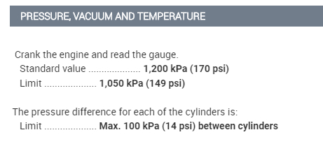

I still have a misfire but no check engine light comes on. And you can feel it when you slowly accelerate but, no check engine light. So change the spark plugs hoping that maybe it was one plug bad. No good. I’ll try to have the compression texted this week. I was just going to change wires Just for shits and giggles I already change the ignition modular. Unfortunately it’s a cheap one $50.00. There is a button on the right side of the engine cowling like a reset and I can’t remember what it’s for with somebody pointed it out to me once before. I pushed it and it clicked so I don’t know what that’s for. LOL right now I have the battery disconnected to see if I can reset the computer and go from there. It’s all I can think of now.
Saturday, February 1st, 2020 AT 11:32 AM
Yeah. I think the compression needs to be the next thing because without a good base engine operation all else doesn't matter. So if nothing else, it will just confirm it is sound. Thanks
