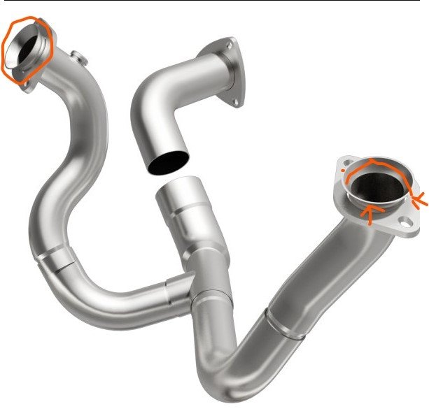

Okay, where the manifold is the up pipe that connects to the manifold does not have a gasket it just has like a nipple that looks like it just bolts up, but for the life of me I cannot get the thing to seal. it's minor but it's enough to still be able to hear it going down the road or while accelerating. I just cannot get it to seal off. Please, if you have any time for hints or tricks, please let me know. thanks, Matt

Matt, are you referring to the EGR tube? See pic 1. If that is the part, is there any evidence of damage to either side? Also, are you sure the connection is leaking and it's not the manifold? The exhaust manifolds are known to crack and leak at the manifold gasket. Often, you will hear a ticking sound that lessens as the engine warms up.
If possible, record what you hear and upload it for me to hear.

That is a common problem with that design. The easiest trick is to lower the pipe down, then go around it with a hammer and gently tap the metal in around the flange where you can see it leaking. You are reforming the seal so that when you tighten the flange bolts it forms to the manifold. Use new studs and nuts. Then run it until the exhaust is hot and then go in and torque the flange nuts down again. It can take 2-3 heat and tighten cycles to get used parts to seal up fully.
Also be sure it is the flange seal; those engines have a bad habit of the manifolds cracking or the bolt heads breaking off and the manifold leaks then.

Yes, replying to both here. I'm pretty sure it is the up pipe flange earlier I took it down and put it back up to see if maybe I could get a decent seal and it is better, but I can definitely feel the leak coming from that not the manifold. I did check the manifold very well it's holding a well seal, also when I got the truck the catalytic converters had already been taken off and they did a horrible job, if I may say so. but with Ya'll help I should be able to get her going like brand new again. thanks again, Matt

Those pipes can be a pain, I prefer the style that use a donut for the head pipes, that seal good and are replaceable, all metal ones are good when everything is new, and the metal isn't worn or shifted from heat cycles or rust. Another way to get them to seal is to use a torch to heat the pipe up red then tighten it down and let it cool.
