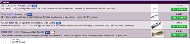

I have to replace my catalytic converter since I have a PO420 code. -I am just wondering what is the OEM for this Honda? also are all catalytic converters three-way or will regular direct fit work for a replacement? O2 sensors are good so that leaves the catalytic converters replacement.
Feb 14, 2019 at 6:52 AM
Good evening,

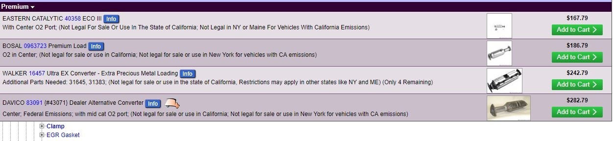

The 420 is a catalytic converter failure.
You need to get a good quality catalytic converter. there are cheap ones out there but they will barely last a year.
You should consider a Walker, Bosal or the original equipment replacement.
I will attach some results for you to view.
