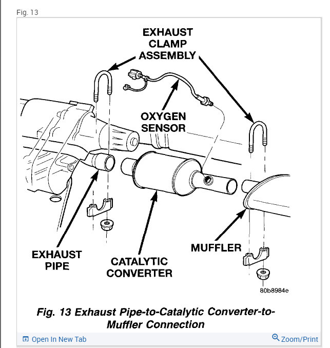

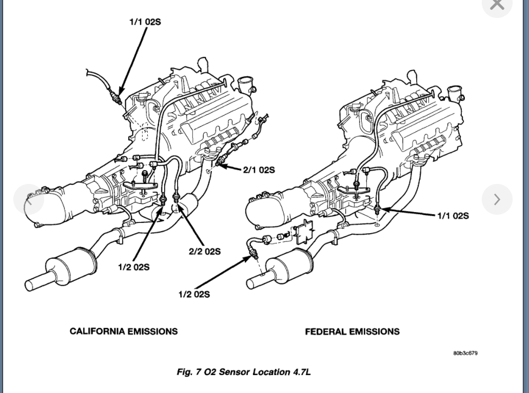

I need an exhaust diagram with all sensors for a 1999 jeep grand Cherokee limited 4.7L 4wd
Feb 27, 2022 at 5:20 AM

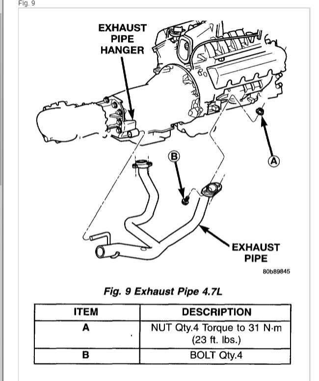

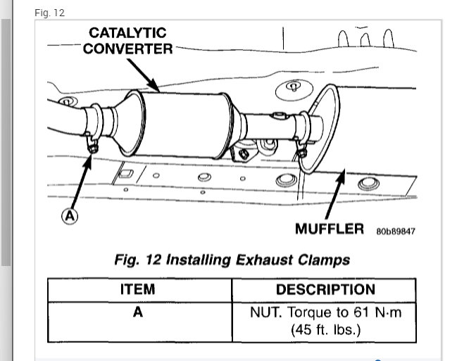

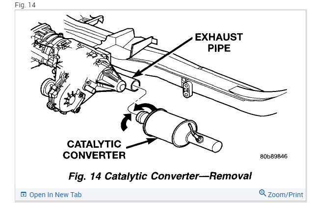

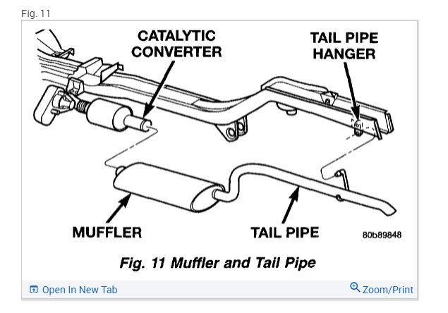

I will attach all the info from the manual but here is a guide that will help with removing the exhaust system in case you need this:
https://www.2carpros.com/articles/exhaust-system-removal
Also please see the info attached. Unfortunately, the manual doesn't have a single diagram that contains all the info on this vehicle, so we are going to have to patch it together through these diagrams.
Please let us know if you need more info and we can go from there.
