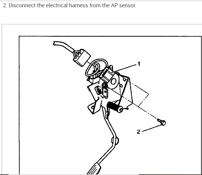

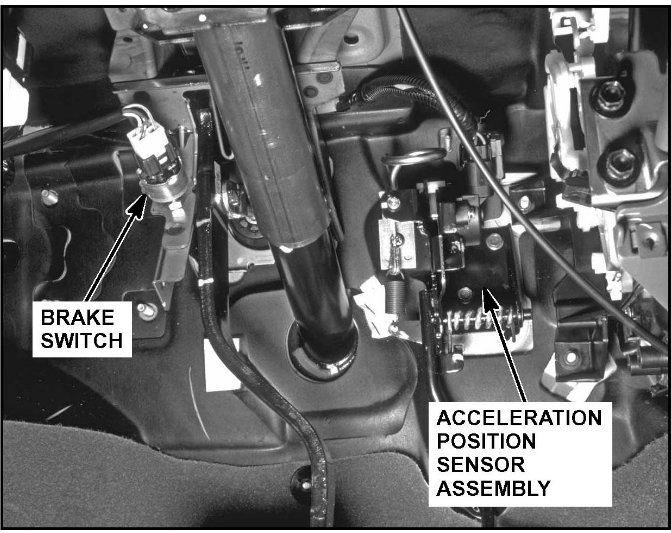

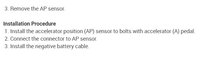

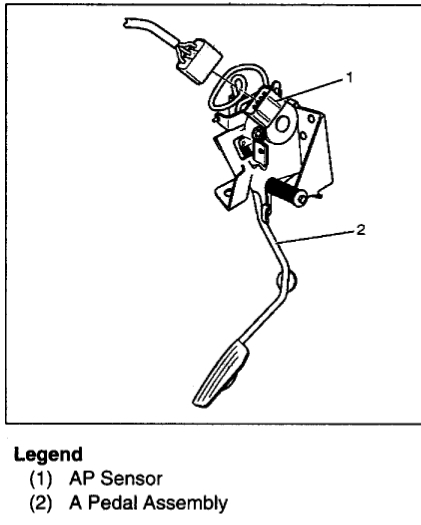

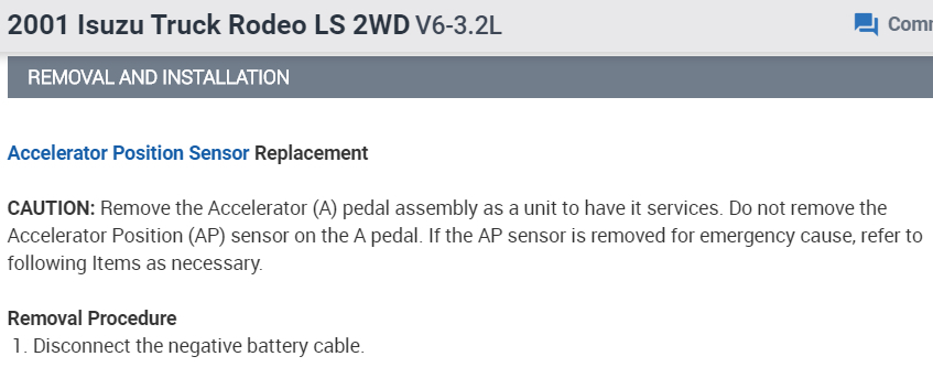

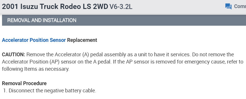

Starts then shuts off and code says I need to replace accelerator pedal sensor. How to do that?
Jun 6, 2020 at 4:13 AM
DANNY L
  • 5,648 POSTS
Hello, I'm Danny.
I've attached step by step pictures below on how to replace the accelerator pedal position sensor.It's mounted to the pedal assembly next to the steering column.Hope this helps and thanks for using 2CarPros.
