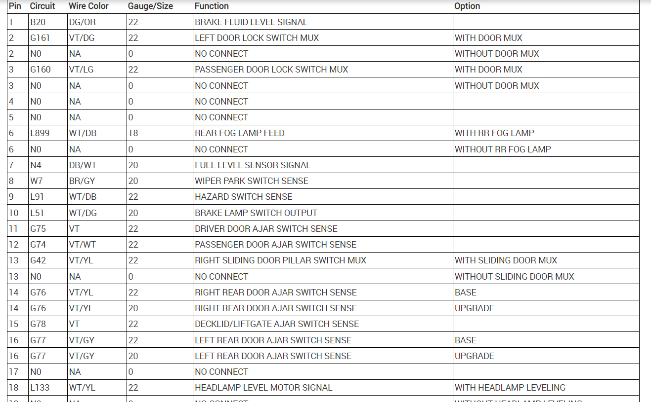

Excessive parasitic draw?

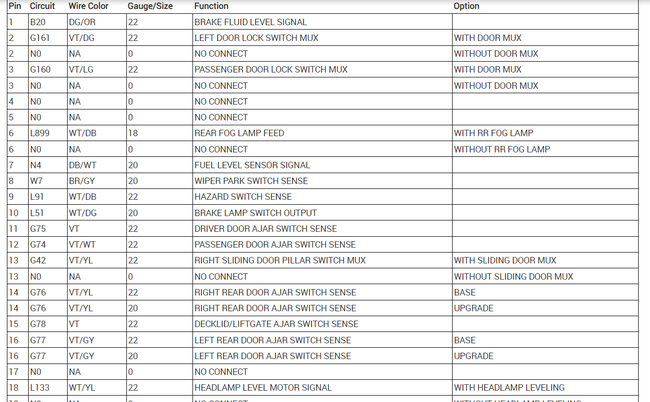

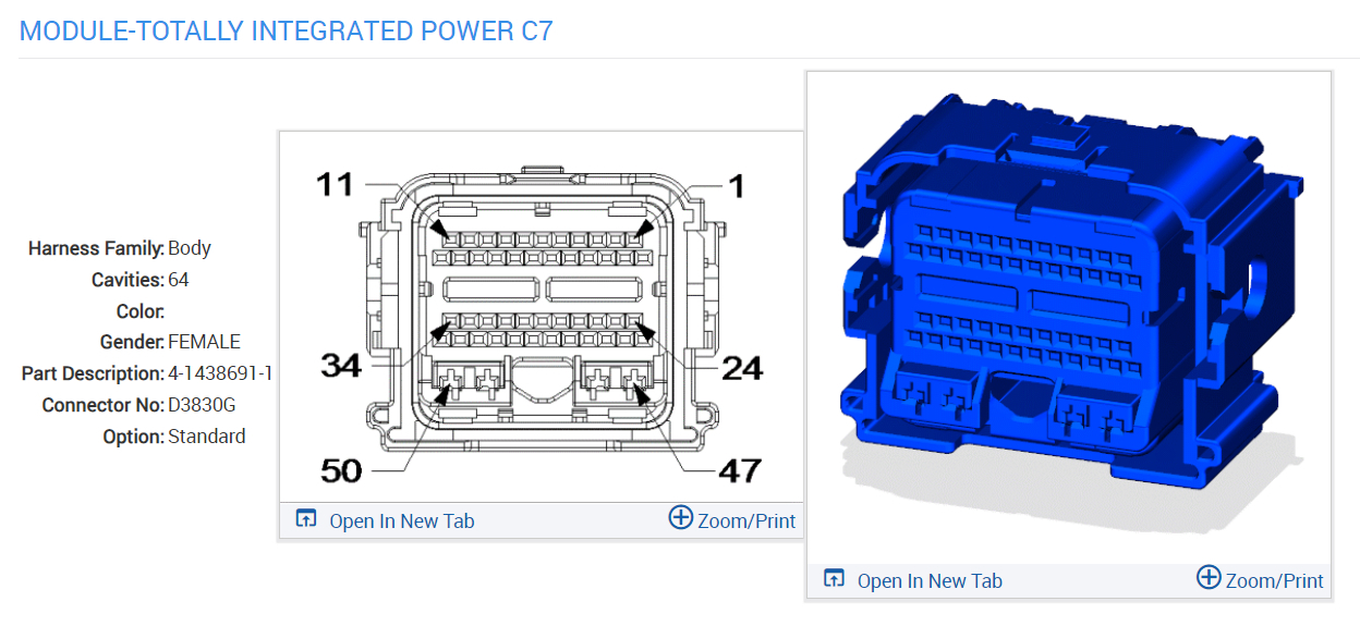

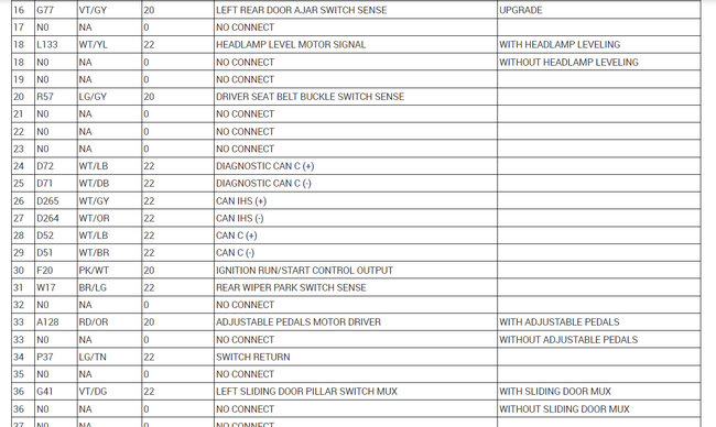

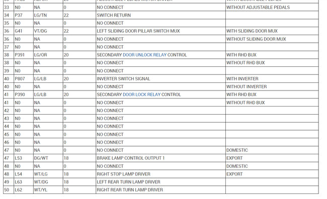

If the van sits for more than a couple of days with the battery connected it completely drains the battery. I've ruined one new battery. I did the amperage test by putting my multimeter in line with the battery negative and pulling fuses one by one. Nothing made a difference in the reading. When I disconnected the positive cable from the TIPM my reading dropped. The original reading was around .7 amp. I reconnected the positive cable and started pulling connectors off the TIPM. When I pulled C7 the amperage dropped again. I'm thinking my draw is happening in the circuits supplied by C7 but I can't seem to find a wiring diagram showing me where the wires go from C7. Can you please help me?
Sep 7, 2024 at 2:29 AM
  • 55,758 POSTS
Sure, here are the accessories that are powered by C7, what sticks out is the sliding door and the adjustable pedals so I would check there first. This guide may help as well:
https://www.2carpros.com/articles/car-battery-dead-overnight
