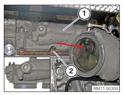

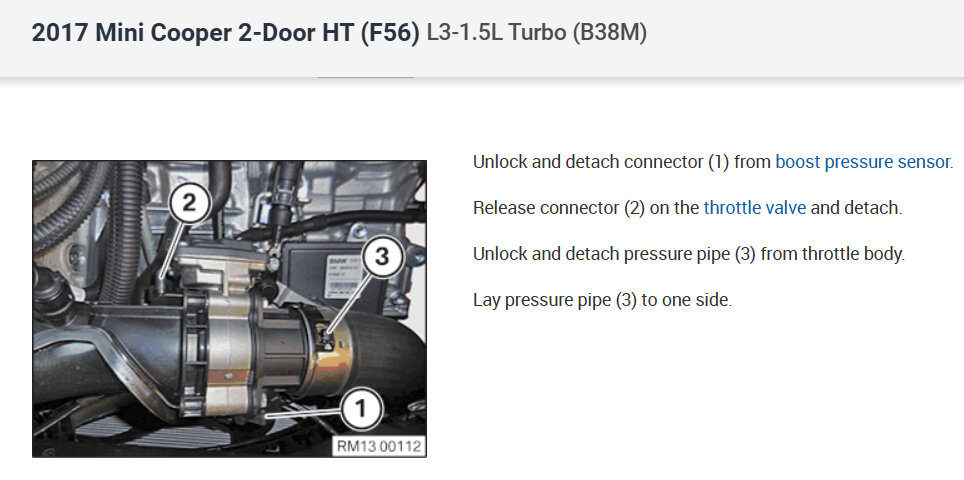

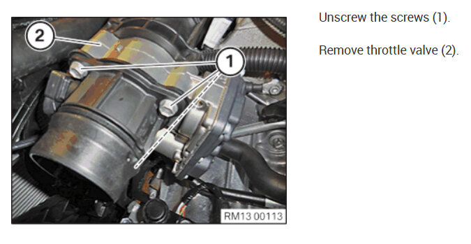

Sure, for heard starting I always begin with servicing the throttle body, this guide will show you how with instructions with the images below for your car.
Here is a guide for hard starting problems that can shine a light on the issue:
https://www.2carpros.com/articles/engine-cranks-excessively-before-starting
Check out the images (below). Please upload pictures or videos in your response of any problems so we can see what to help you with.

Hi Ken,
I checked the throttle body, and it seems pretty clean.
I did notice from one of the links that you provided that if she had a Gen2 type throttle that you couldn't even disconnect it with the battery unplugged which I definitely did as I needed to get the wiring out the way.
When I first checked, it had 2 x MAF sensor air flow too low and 2 x MAF below efficiency. I removed these, did the checks and went for a test drive but so far, the codes have not come back but it may take a few days for that to happen.
I tried a relearning process that I found on the internet, but it hasn't made any difference.

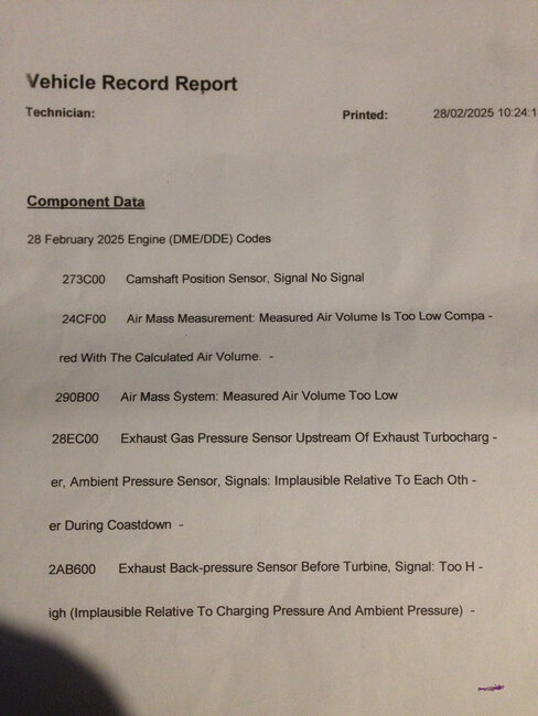

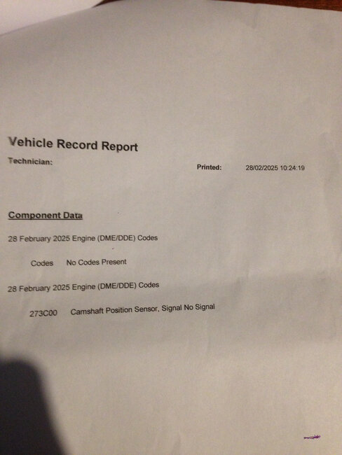

Sorry for the delay in getting back. I haven't had a chance to look at this yet because the car was in for its MOT. Whilst in there, they put their scanner on which must be a bit better than mine as it came up with some extra errors. I thought I would post them in case it helps.
I did try another camshaft sensor after seeing the camshaft error, but it made no difference.
The firs image is before removing codes and the second is the codes that reappeared.
Many thanks.

Can I ask if you cleared the codes once the camshaft sensor was replaced, if not this must be done. Also, these codes are still leaning towards a bad turbo. Need need to do an inspection. Can I ask if you replaced the MAF sensor?
Mar 10, 2025 at 3:25 AM

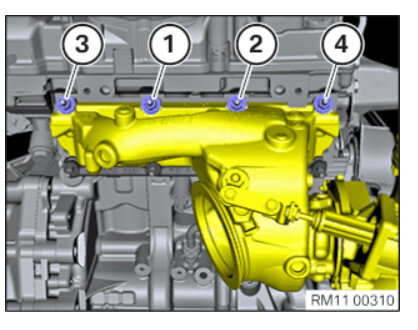

I finally got hold of my daughter's car for a bit and have taken the turbo off to inspect it.
I can see that there has/is some oil seepage into the air intake side. There also seems to be some lateral play and perpendicular play, best guess would be about 3/64 of an inch.

Hi Kevin,
Good find on that. 3/16 is too much endplay in the turbo shaft, I would get a replacement.

There must be a leak between the MAF sensor and throttle body, I would remove the tubing and look for cracks, breakage. Does the engine idle okay? if so check the intake tubing, here is another method you might want to try.
https://www.youtube.com/watch?v=LRKWV4Are5c&t=95s&pp=0gcJCesJAYcqIYzv
Please go over this guide and get back to us.
