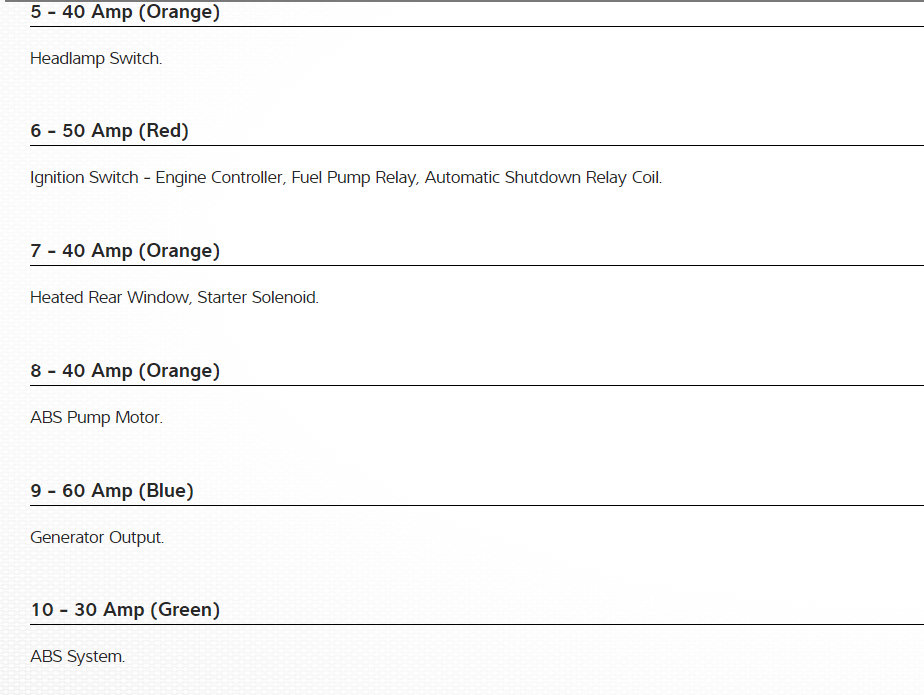

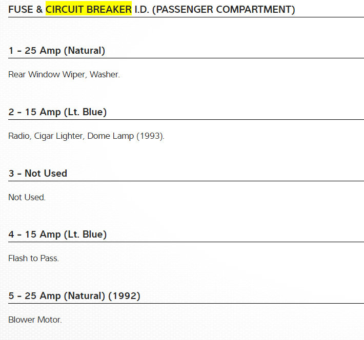

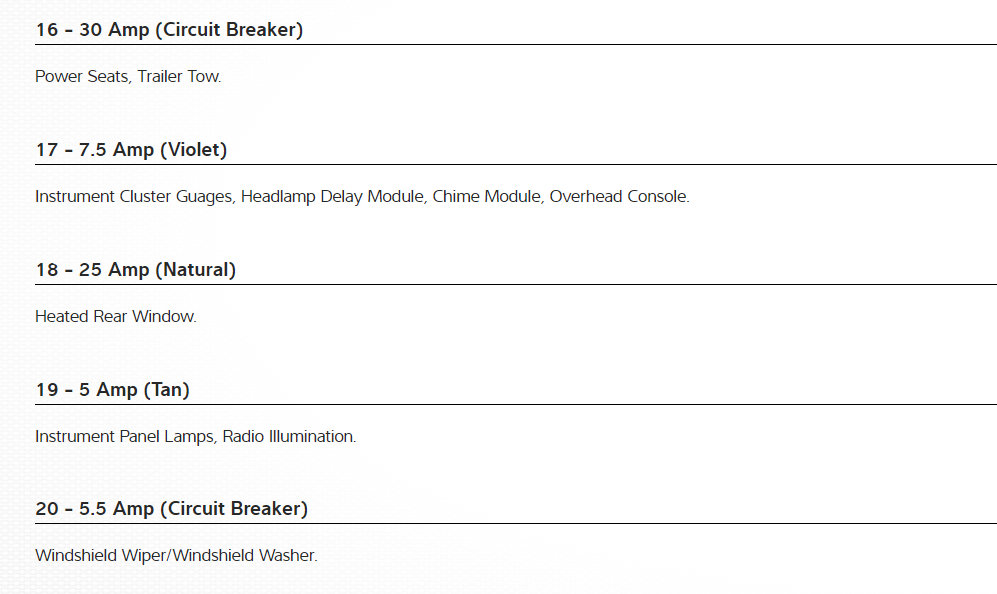

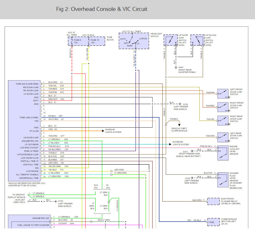

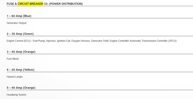

I bought another one on line; installed it and it does not power up. What are some possible root causes (i.e. perhaps a breaker - if so where would it be located?). I checked the fuses and all look okay.
Oct 8, 2018 at 11:56 PM
  • 55,710 POSTS

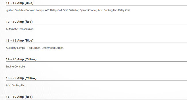

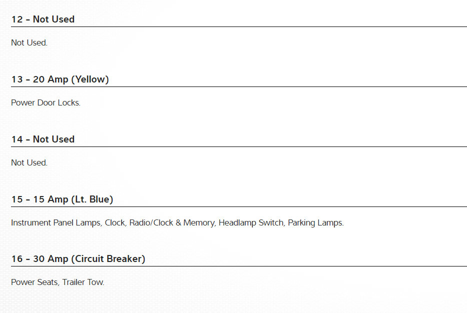

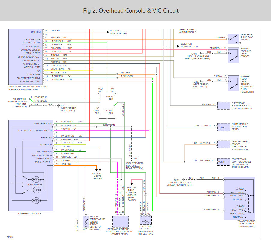

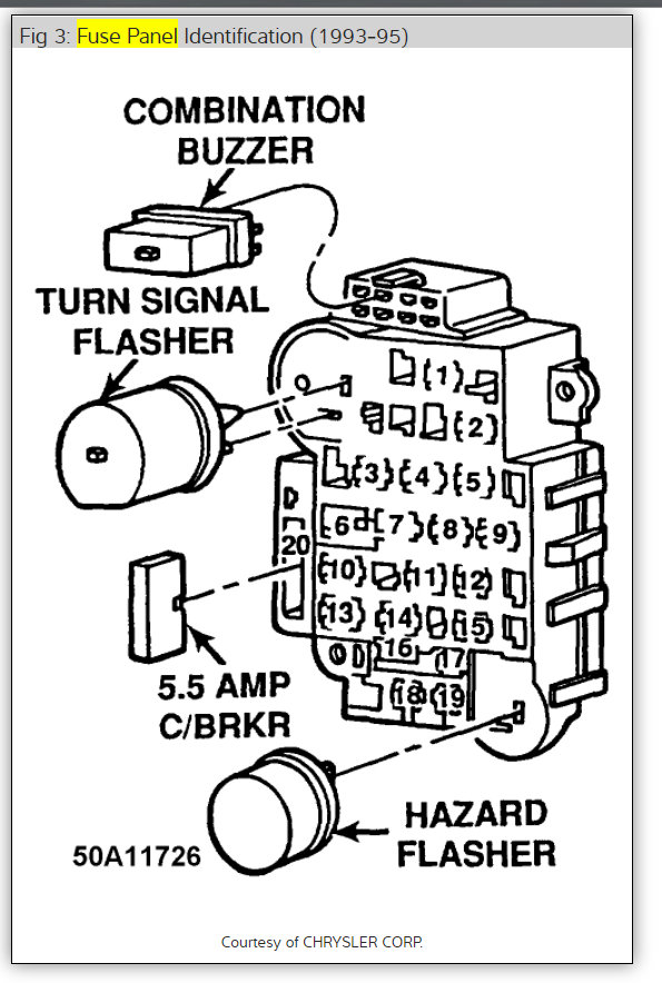

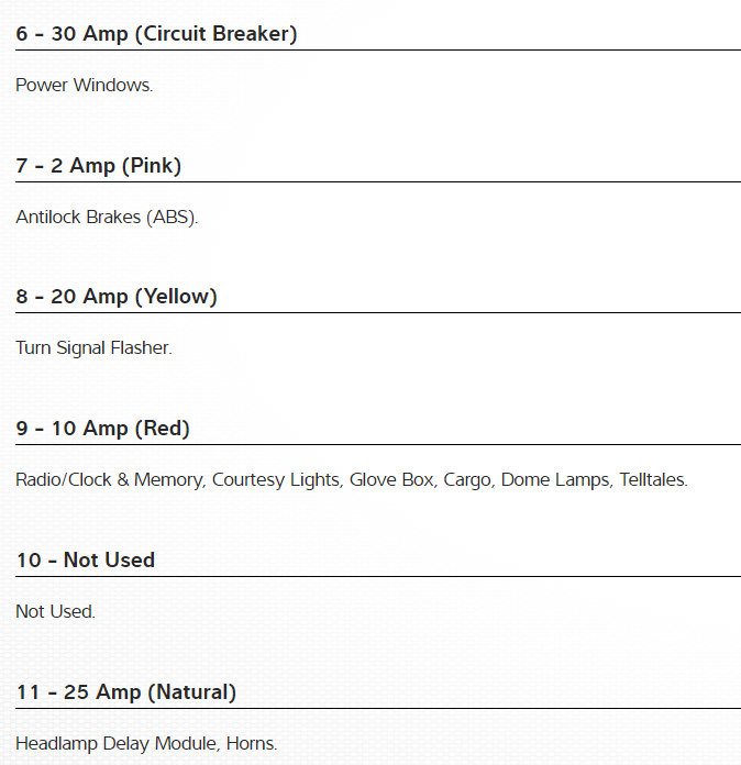

It sounds like you lost power or ground. Here is a guide to help you do testing and the wiring diagrams so you can see how the unit works. Check fuses # 8 and #19.
Test power and ground easy! Check out the diagrams (below). Please let us know what happens.

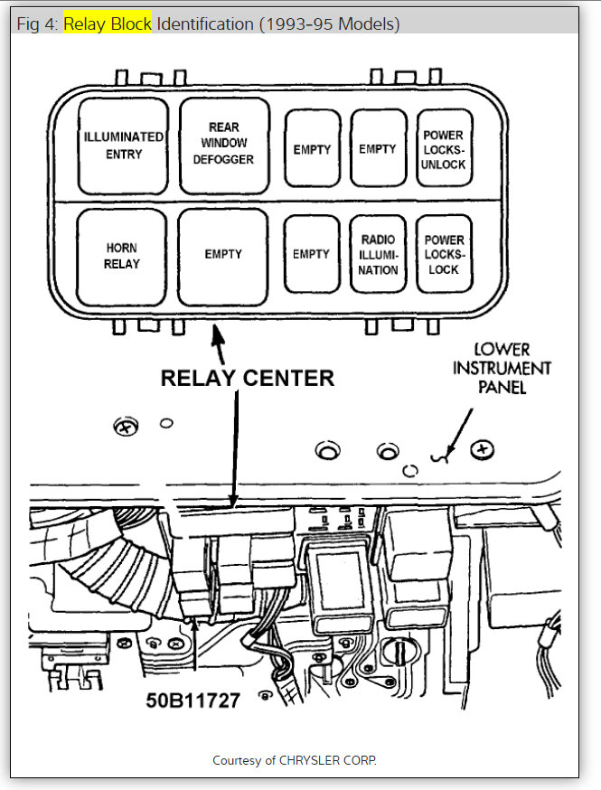

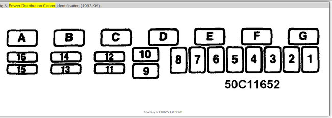

Is this module controlled by both a relay and a fuse? If so, where are these located (I.e. under the hood or in the car cabin)?
Oct 12, 2018 at 3:52 AM (Merged)
  • 55,710 POSTS
You did not like the answer I gave you? You have all the information needed above.
