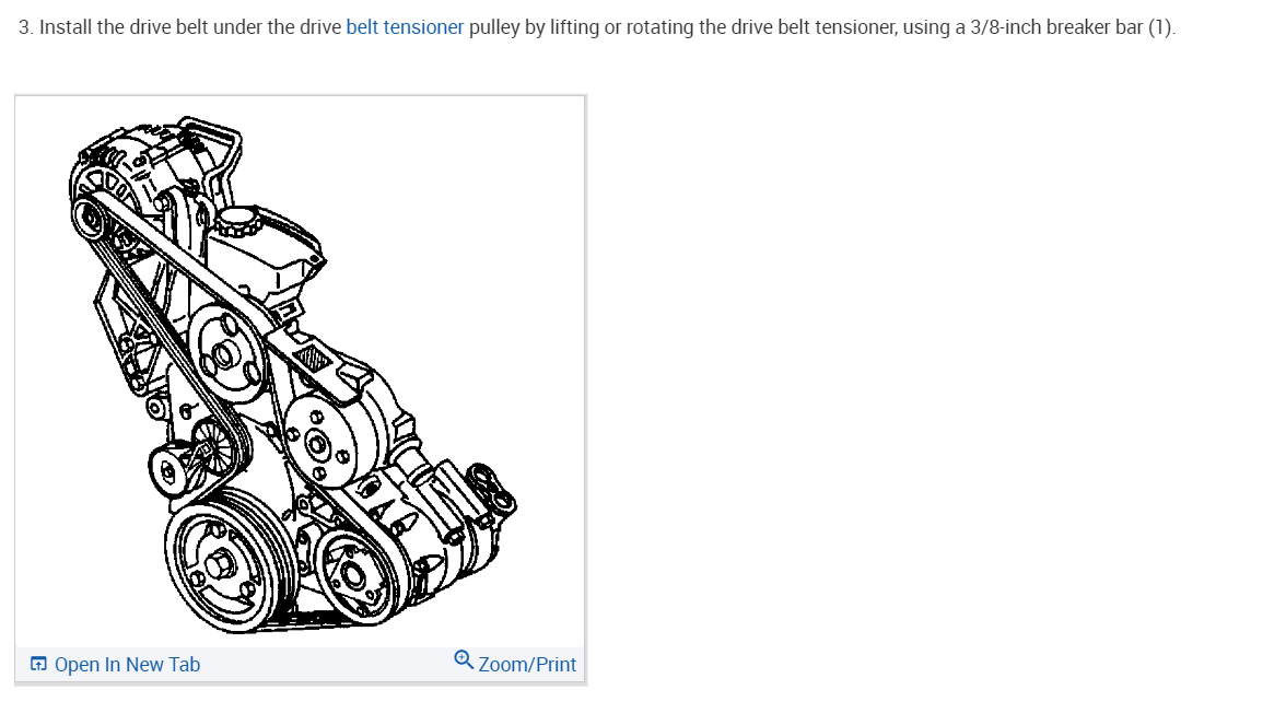

Hi, I was driving the other day and the brakes locked up and the power steering went out at the same time while I was going around a corner. I pulled over, parked, and shut off the car. When i turned it back on the battery light was on. I went around the block and parked it at home. I have been experiencing other nuisances my car will tell me I am low on anti-freeze when I am not. It will overheat while I have plenty in the radiator and in the reservoir. I want to fix it. It's a really good car. How much am I looking at to fix my car?
Oct 18, 2022 at 4:27 PM
  • 55,721 POSTS

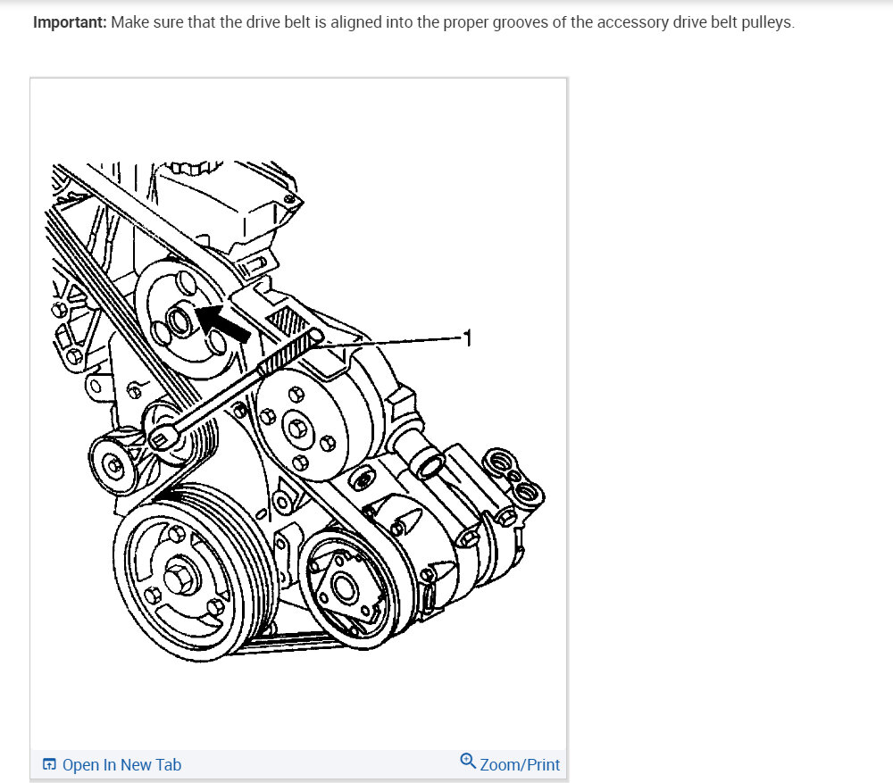

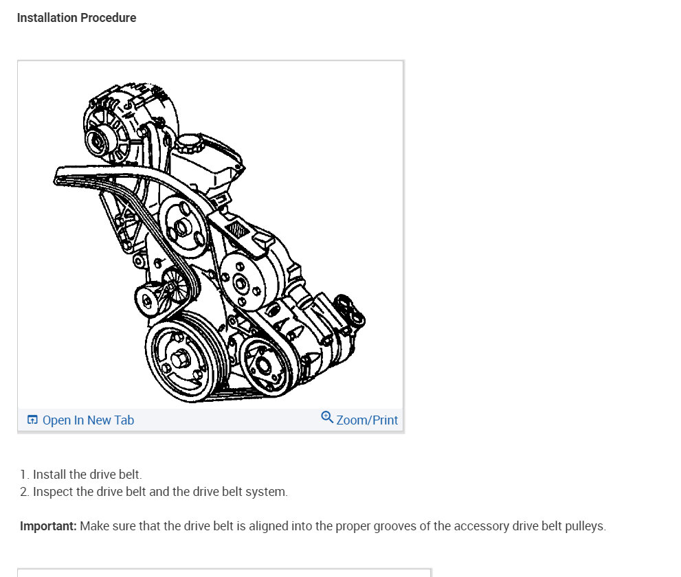

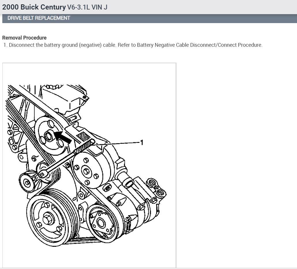

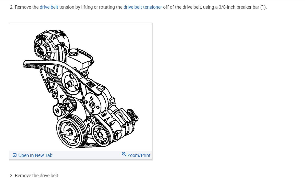

It sounds like you lost the serpentine belt. I would lift the hood and check the drive belt. here is a guide to help walk you through and images below for your car:
If the belt is okay, we need to run the codes.
The bet should cost about $35.00 from the parts store or about $140.00 for a shop to fix. Check out the images (below). Let us know what happens and please upload pictures or videos of the problem.
