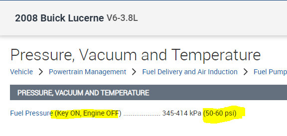

If this happened after running out of fuel, chances are it has nothing to do with the ECM. Often times, the fuel pump is damaged which lowers or prevents fuel pressure from being achieved.
The first thing I would do is check the fuel pump pressure. Here is a link that shows how it's done:
You will need a fuel pressure gauge, but most parts stores will lend one to you.
I attached the manufacturer's fuel pressure specifications for you below. Try this and let me know what you find.
See pic below.
