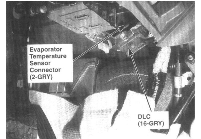

evaporator temperature sensor
2003 HONDA CRV
150,000 MILES
ARMANDO ERAZO
Diagnostic Trouble Code (DTC) seven through thirteen. When problems in the evaporator temperature sensor circuit are detected I got this problem those any one knows where is the location for this sensor TKS for any? help.

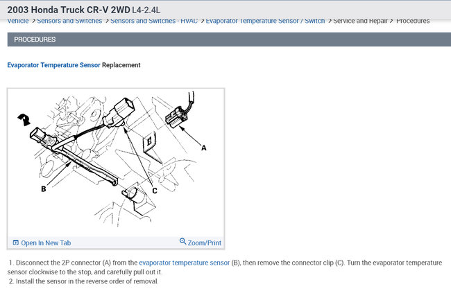

The evaporator temperature sensor is located at the evaporator here are the instructions on how to change it in the diagrams below. Please let us know if you need anything else to get the problem fixed.
