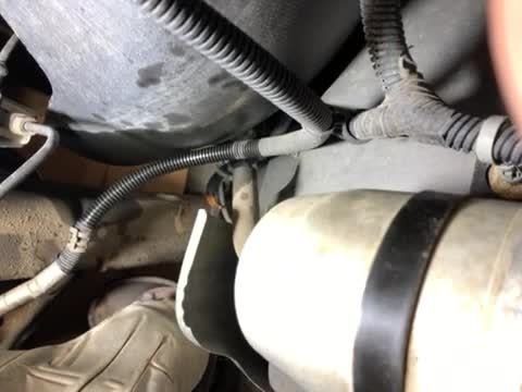

I have radiator fluid leaking from my breather tube on the motor side of the evaporator. Looking for any advice on how to remove the whole evaporator, heater core module to get the evaporator out.

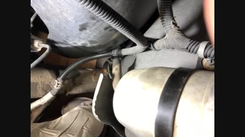

The pick up is not leaking anti freeze.it is leaking a green liquid from the breather tube on the motor side of the heater core/evaporator module. I got the heater core out (forcefully) and there was no anti freeze where the heater core sits. I am more wondering if anyone has a detailed diagram of what bolts/nuts and placement of said bolts and nuts that need to be removed to get the entire module out to get the new heater core in and to check the evaporator for any leaks.

Can you post a picture of the leak? I want to see what you see.
Oct 3, 2019 at 3:43 PM
TYLER TRETTER
Video.
Oct 3, 2019 at 3:45 PM

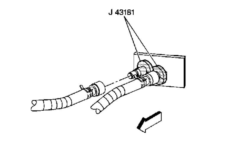

Okay, steps below:
1. Install the J 43181 to the heater core pipe.
2. Close the tool around the heater core pipe.
3. Firmly pull the tool into the quick connect end of the heater hose.
4. Firmly grasp the heater hose. Pull the heater hose forward in order to disengage the inlet hose from the heater core.
3. Using the J 43181 disconnect the surge tank outlet hose from the heater core.
4. Firmly grasp the heater hose. Pull the heater hose forward in order to disengage the surge tank outlet hose from the heater core.

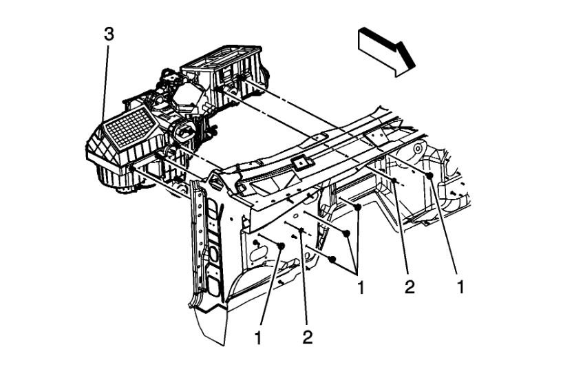

4. Remove the upper intake manifold sight shield. Refer to Upper Intake Manifold Sight Shield Replacement (See: Intake Manifold > Removal and Replacement) .
5. Remove the battery. Refer to Battery Replacement (See: Battery > Removal and Replacement > Battery Replacement) .
6. Remove the accumulator. Refer to Air Conditioning Accumulator Replacement (Non-HP2) (See: Accumulator HVAC > Removal and Replacement > Air Conditioning Accumulator Replacement) .
7. Remove the instrument panel to the service position. Refer to Instrument Panel Service Positioning (without SLT) (See: Dashboard / Instrument Panel > Removal and Replacement)Instrument Panel Service Positioning (with SLT) (See: Dashboard / Instrument Panel > Removal and Replacement) .
8. Remove the nuts (2) from the HVAC module (3).
9. Remove the bolts (1) from the HVAC module (3).
10. Remove the HVAC module (3).

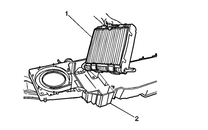

Air Conditioning Evaporator Core Replacement
Removal Procedure
1. Remove the HVAC module. Refer to HVAC Module Assembly Replacement (See: Housing Assembly HVAC > Removal and Replacement > HVAC Module Assembly Replacement) .

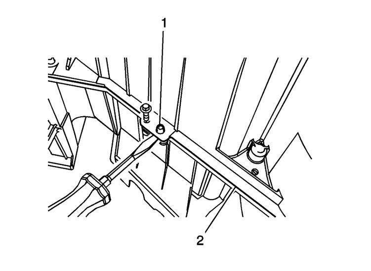

2. If equipped remove the heat stakes (1) from the HVAC module (2) with a screw driver and a hammer.
3. Disconnect all wiring connections from blower motor, blower motor control module and sensors. Also, remove all wiring from retainers before removal.
4. If equipped remove the screws from the HVAC module assembly.
5. Remove the evaporator cowl gasket from the evaporator.

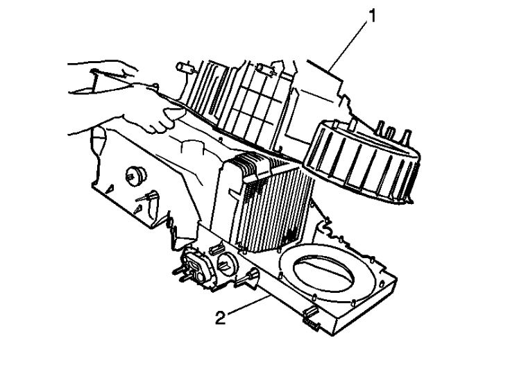

6. Separate the upper HVAC module assembly (2) from the lower HVAC module assembly (1)
7. Remove the evaporator core (1) from the upper HVAC module assembly (2).
