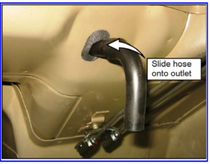

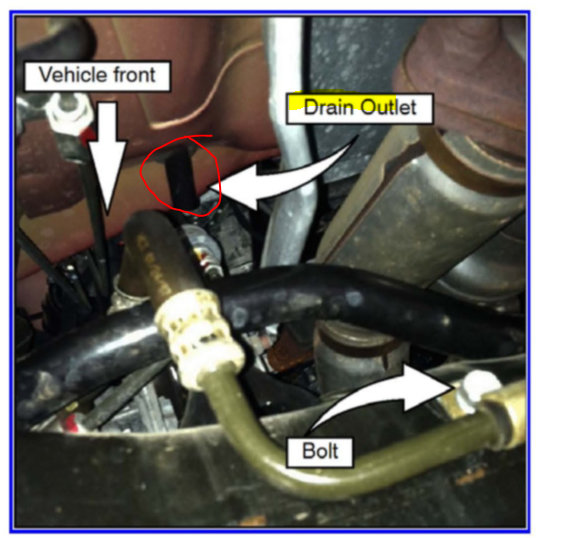

I have the car listed above that has water pooling in the passenger side foot well. I've recently replaced the blower motor to get my A/C to work, but now I think the evaporator line/drain is clogged.
I cannot locate where the drain is located to try and clear it and there's no one online that has a clear image and location of the drain.
Any help is appreciated!!
Aug 5, 2022 at 9:54 AM
  • 110,248 POSTS
The drain is located on the passenger side of the vehicle. It comes directly from the HVAC box, through the firewall, and out of the vehicle.
I attached a couple of pics below. Let me know if they helped you locate it.
Also, if you find it isn't clogged, let me know. I have to dig through some things, but for some reason, I remember a technical service bulletin that may help.
Let me know if this helps.
