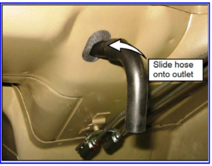

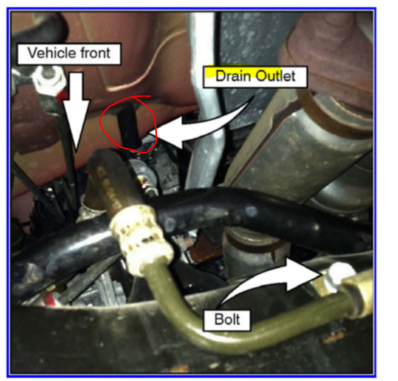

I have the car listed above that has water pooling in the passenger side foot well. I've recently replaced the blower motor to get my A/C to work, but now I think the evaporator line/drain is clogged.
I cannot locate where the drain is located to try and clear it and there's no one online that has a clear image and location of the drain.
Any help is appreciated!!

The drain is located on the passenger side of the vehicle. It comes directly from the HVAC box, through the firewall, and out of the vehicle.
I attached a couple of pics below. Let me know if they helped you locate it.
Also, if you find it isn't clogged, let me know. I have to dig through some things, but for some reason, I remember a technical service bulletin that may help.
Let me know if this helps.
